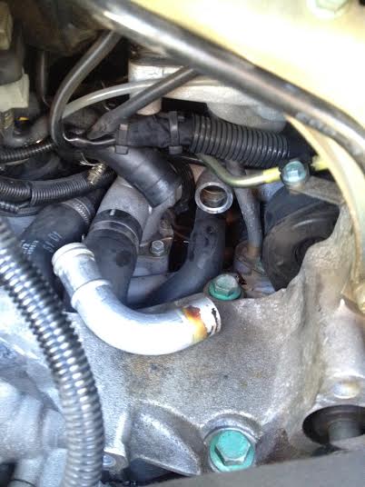

I found it! It's the fitting BEHIND the alternator. I can barely see it but I felt around down there and was able to verify that it is dislodged from the housing. Now how to get to it... I'm guessing alternator and intake pipes have to come out??

if you had one fail, you will have other in the future, better take the engine out and do them all, search the forum for coolant fittings, there are plenty of threads on this, you are just one other unlucky guy. GT3s have the same problem.

Thanks for the all the help guys. Here's the culprit (attached):
I used the following threads for help in removing the alternator and diagnosing the problem, for whoever else has this misfortune:
https://www.6speedonline.com/forums/...e-replace.html
https://www.6speedonline.com/forums/...top-motor.html
Any specific JB weld to use on this? I can't drop the motor right now but it will come out for injectors soon so I'll have them welded then.
thanks,
H

Hi. i just had the same problem.
if i were you i'd wait and do it right. meaning take the engine out and fix all 7. weld them and since the age of the car predicts this fail, change all hoses, water pump, radiator tank, ext. its going to be costly, but the bright side is, you didn't get hurt and your engine is still good. if it failed in the cold season, its time to fix em...
