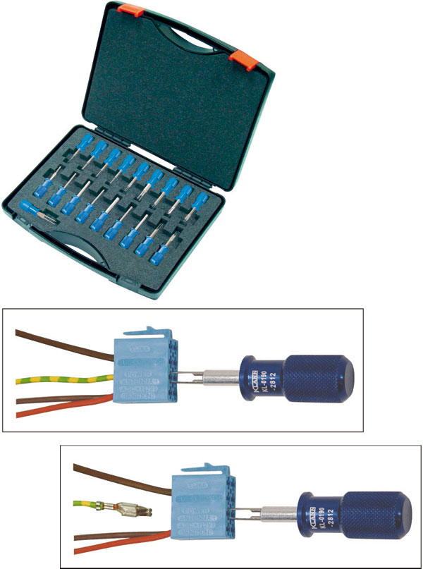

Originally Posted by PL2
Hello,
000-998-229A is plug and play.
Best $60.00 spent on a car.
In a nutshell:
The hazard switch needs to be removed from the instrument cluster housing.
The instrument cluster and housing needs to be lifted away/propped up from the dashboard.
The hazard switch electrical socket needs to be removed from the instrument cluster housing.
5 wires need to be removed from the hazard switch electrical socket and re-connected into the corresponding adapter harness socket.
Tuck away the adapter relay onto one of the empty cavities behind the cluster.
Reassemble in reverse order.
No soldering or wire cutting required.
Totally reversible and the relay is passive.
Removal of relay from adapter harness puts system back into "stock mode."
Total time.. 1 hour with your favorite beverage close by.
Write up to follow..
OP, what tool did you use to get the wires out of the hazard connector ? Which wiring parttern did you use ? The VW Golf or Passat pattern ?
I looked up the recommended electronic tool and its nothing like I can find locally

rxbike,
I found this kit: Schwaben Electrical Terminal tool kit #CE-70-2 for about $70 at one of the Vendors listing the 000 998 229A kit. Don't know if protocol permits mentioning the name of the vendor so PM me if interested. I'm planning to order the tool kit and the Comfort Module at the same time.
Regards,
GE
Old Jan 21, 2014 | 08:02 AM
  #29
PL2's Avatar
PL2
Joined: Mar 2013
Posts: 9
From: Washington, D.C.
PL2 is infamous around these parts
Sorry for the silence...
I'm checking the wiring diagrams for 2001-2005 TT's to make sure that the wire colors are the same and I'm looking for an economical solution for the electrical connection pin release tool.
I borrowed the Klann "KL-0190-2812" as illustrated in the photo attached below.
I'm positive that you can purchase this tool separately from another manufacture since it's an Volkswagen Group tool.

PL2
Thanks for the post ... Must be a way to make that darn tool for a one time install
Edit:
Think I found one that will work. Just ordered it and cheap too
http://www.amazon.com/Lisle-56500-Terminal-Tool/dp/B0009OR906/ref=pd_bxgy_auto_img_z http://www.amazon.com/Lisle-56500-Terminal-Tool/dp/B0009OR906/ref=pd_bxgy_auto_img_z
