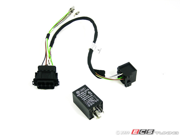

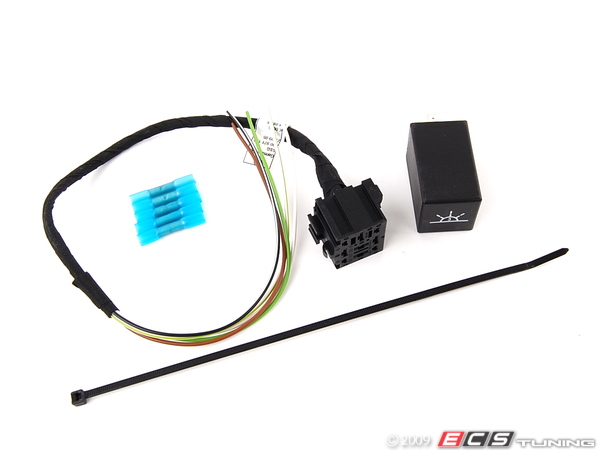

I also own vehicles that have comfort blinking and miss the feature when driving my older cars...
There is a retrofit kit for comfort blinking.
It involves splicing into the wiring harness that leads to the Hazard switch.
It involves connecting 5 wires into said harness.
The kit that uses butt connectors:
VW# 000-998-229
And the kit that uses a very nice electrical connector that MAY cleanly connect into the factory harness:
VW# 000-998-229A
I have purchased both kits and will attempt to install 000-998-229A in my 996.
Will report back in a few days and if time permits.. post a how to.

Hello,
000-998-229A is plug and play.
Best $60.00 spent on a car.
In a nutshell:
The hazard switch needs to be removed from the instrument cluster housing.
The instrument cluster and housing needs to be lifted away/propped up from the dashboard.
The hazard switch electrical socket needs to be removed from the instrument cluster housing.
5 wires need to be removed from the hazard switch electrical socket and re-connected into the corresponding adapter harness socket.
Tuck away the adapter relay onto one of the empty cavities behind the cluster.
Reassemble in reverse order.
No soldering or wire cutting required.
Totally reversible and the relay is passive.
Removal of relay from adapter harness puts system back into "stock mode."
Total time.. 1 hour with your favorite beverage close by.
Write up to follow..
