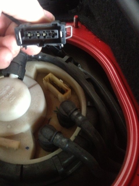

Old Jan 4, 2014 | 03:43 PM
Joined: Oct 2004
Posts: 9,730
From: CHICAGO
Rep Power: 604
Originally Posted by Tim941NYC
Plus 1. Fuel pump/filter?
Yep,
look for this , melted socket etc... in pic the housing is brown/melted...

yes sounds like popcorn. i could not find a good way to describe it.
I will look for that sockes marskei and log and send to EPL asap.
