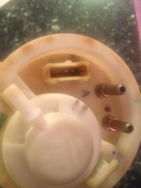

Old Jan 14, 2014 | 04:34 PM
Joined: Oct 2004
Posts: 9,730
From: CHICAGO
Rep Power: 604
check your terminals.... if its melted its the pump...

Checked the Terminals and these are ok. Just ordered a new pump and hope that this will solve my problem.
