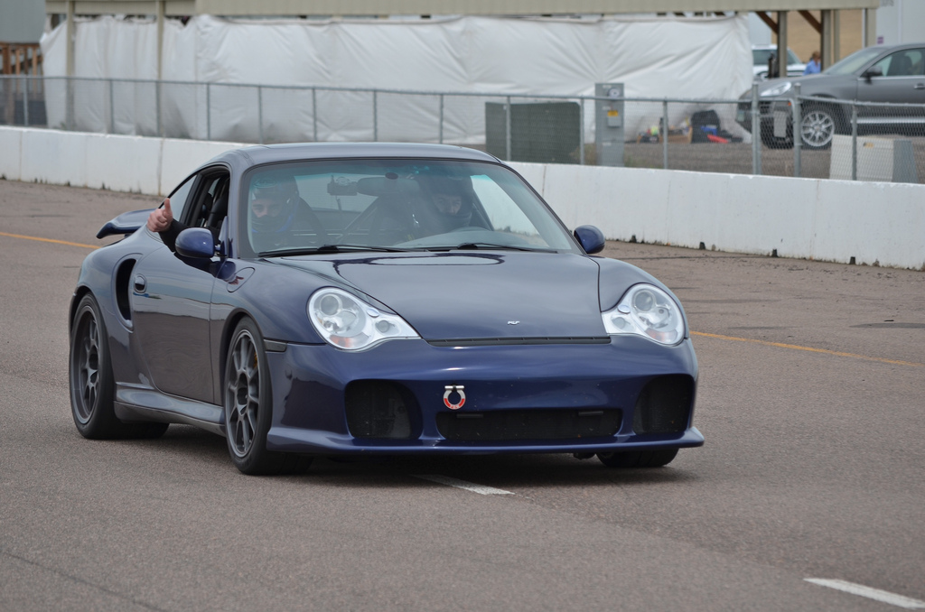

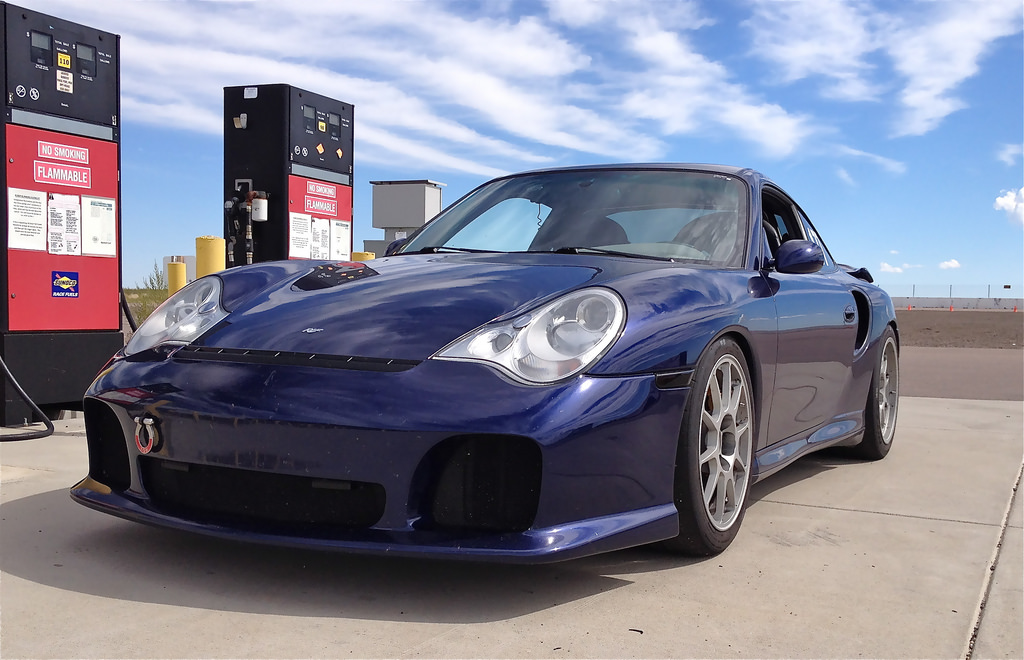

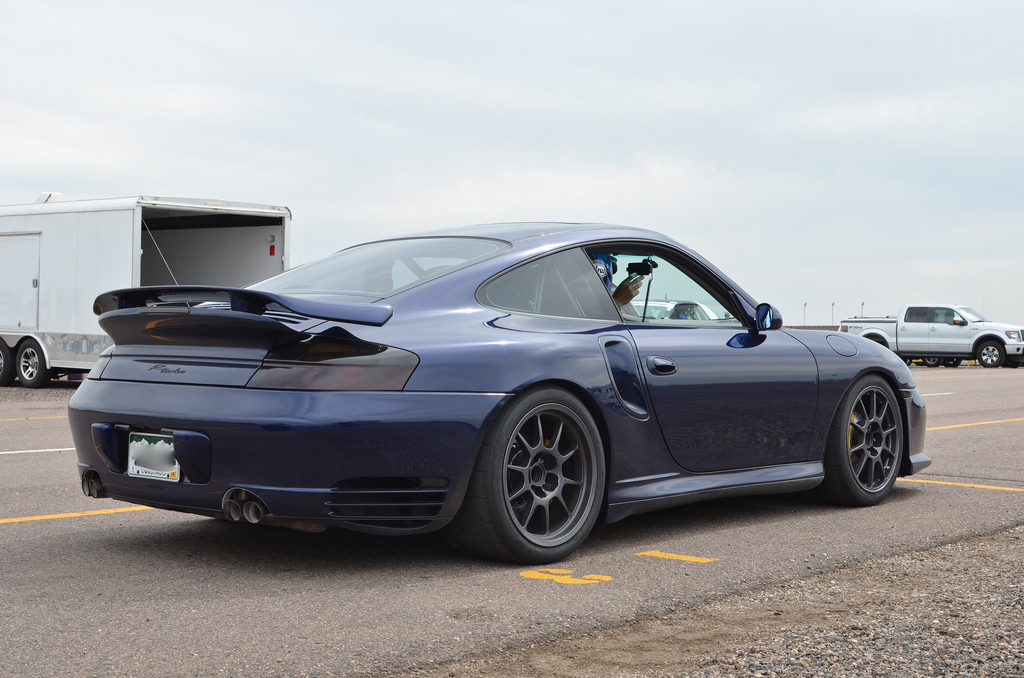

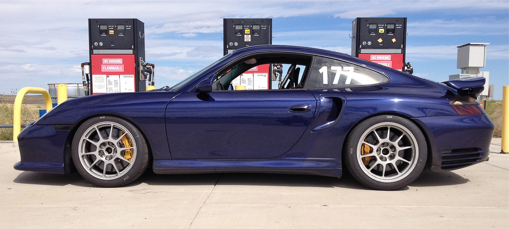

Those are good offsets. I run 18x9 et47 and 18x12 et41. My fronts track is widened 10mm per side due to LCA shims to run -3.0 camber. My rear fenders are rolled and you will probably need to do so. Tires on the car with the silver wheels are NT01 245/40/18 and 305/35/18. If you track you car at all, the NT01s beat the R888 hands down plus you can swap then side to side. They are also quieter compared to the 8s.
If you are AWD, than you're pretty much stuck with a 235/40/18 and 315/30/18 as pictured below with the car on NT01s and also 18x9x12s. This is what I ran prior to my current set up. Still works well, just not as well since the 315 has a smaller contact patch and rolls over more due to the softer sidewall. I can run about 4psi less on the 305 compared to the 315..
