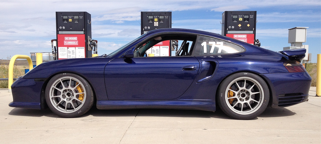

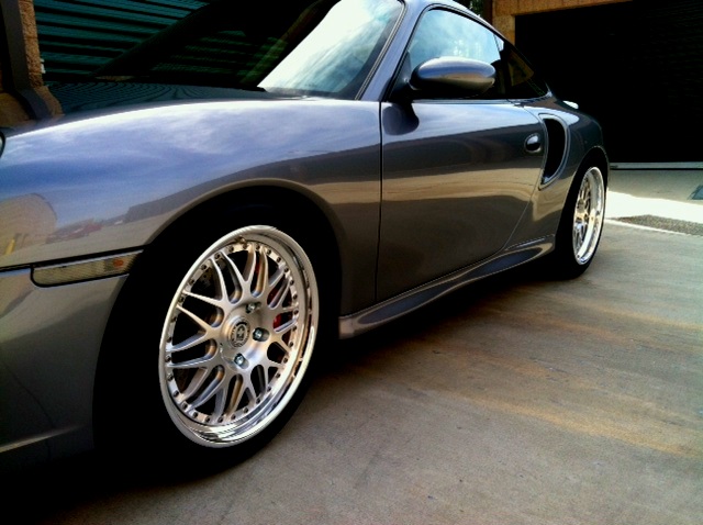

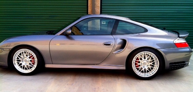

Better images of my set up. No rubbing with my GT2 setup.
Name:	porsche side.jpeg
ID:	343618   Click image for larger version
Name:	porsche wheels side view.jpeg

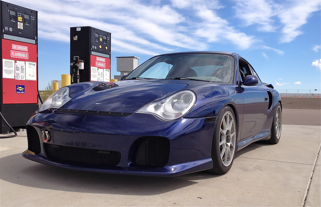

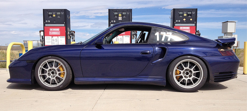

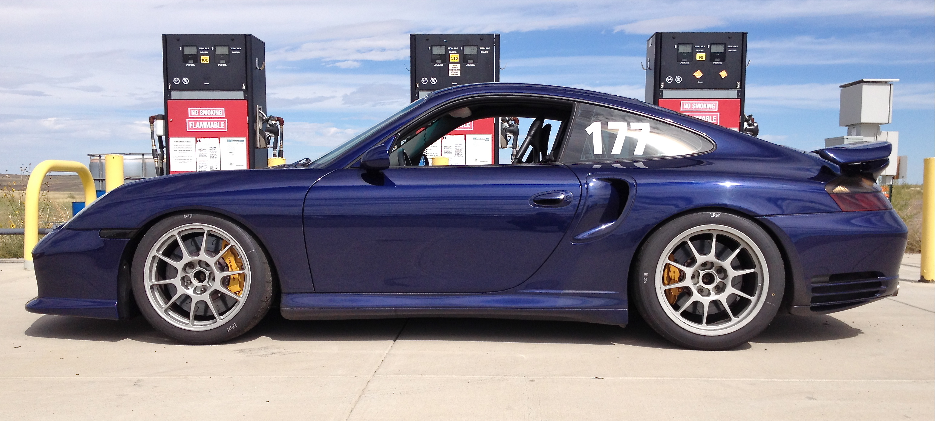

With the 245/40 & 305/35 I run 33/34psi hot at the track. I start at 27/28 cold and and bleed down to maintain 33/34 at the end of a session. For street use I run 34/37. My alignment is -2.9F and -2.25R. Ride height is 102/125mm. 3245lbs with fuel. You will have to realign the car once you have your rake set. Here are some pics...
ID:	343820   Click image for larger version
ID:	343821   Click image for larger version
ID:	343822   Click image for larger version

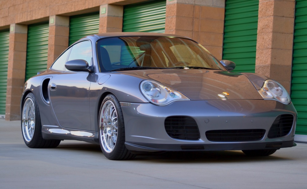

A better image of my set up. 235 and 315's
Jim
Name:	Porsche new set up.jpg
