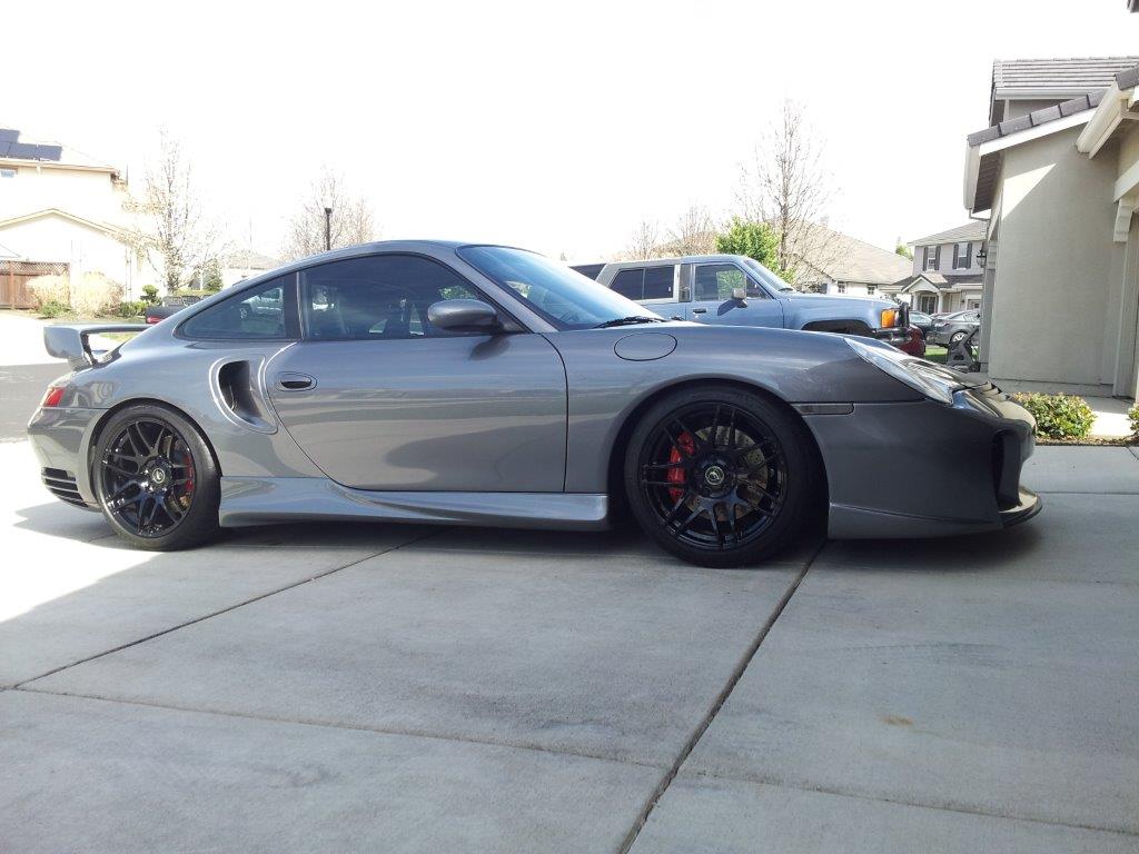

whereits at.. add 5mm to the offset (making it a 40). trust me. r888's run a teeny weeny bit tall and have a squared sidewall. what this means is that the wheel will look tucked in. i have r888s on a 12" myself and i run a 7mm spacer in the rear.
here's a 335 on a 12" forgestar. crazy huh ?
