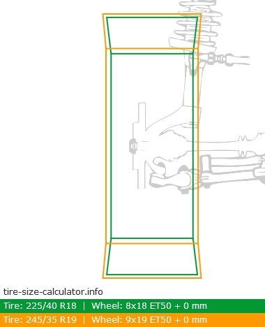

Thanks for the data guys. Seems like the info I received from Peter @ Forgestar and Damon @ TireRack was right in the ball park. For a nice visual representation, I have found this website (http://www.tire-size-calculator.info), FRONT & REAR.

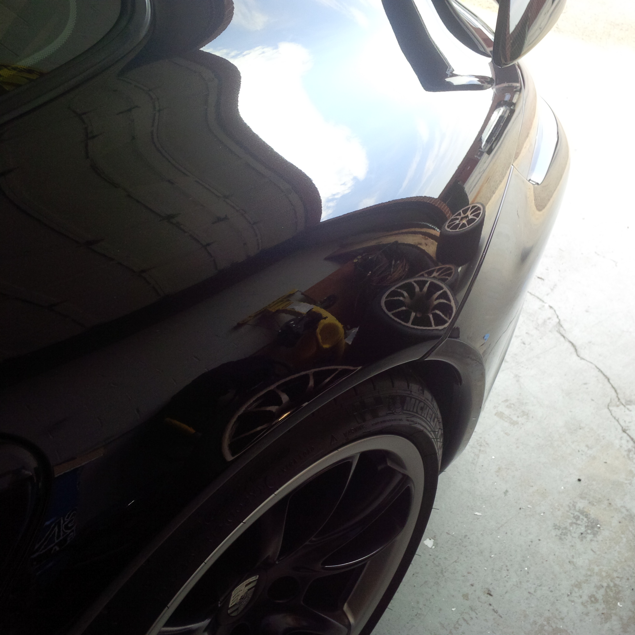

you'll be fine with 305 michelins, thats what i run on my 12" wheels.
Are yours 305/30-19? Sidewall looks pretty thin?

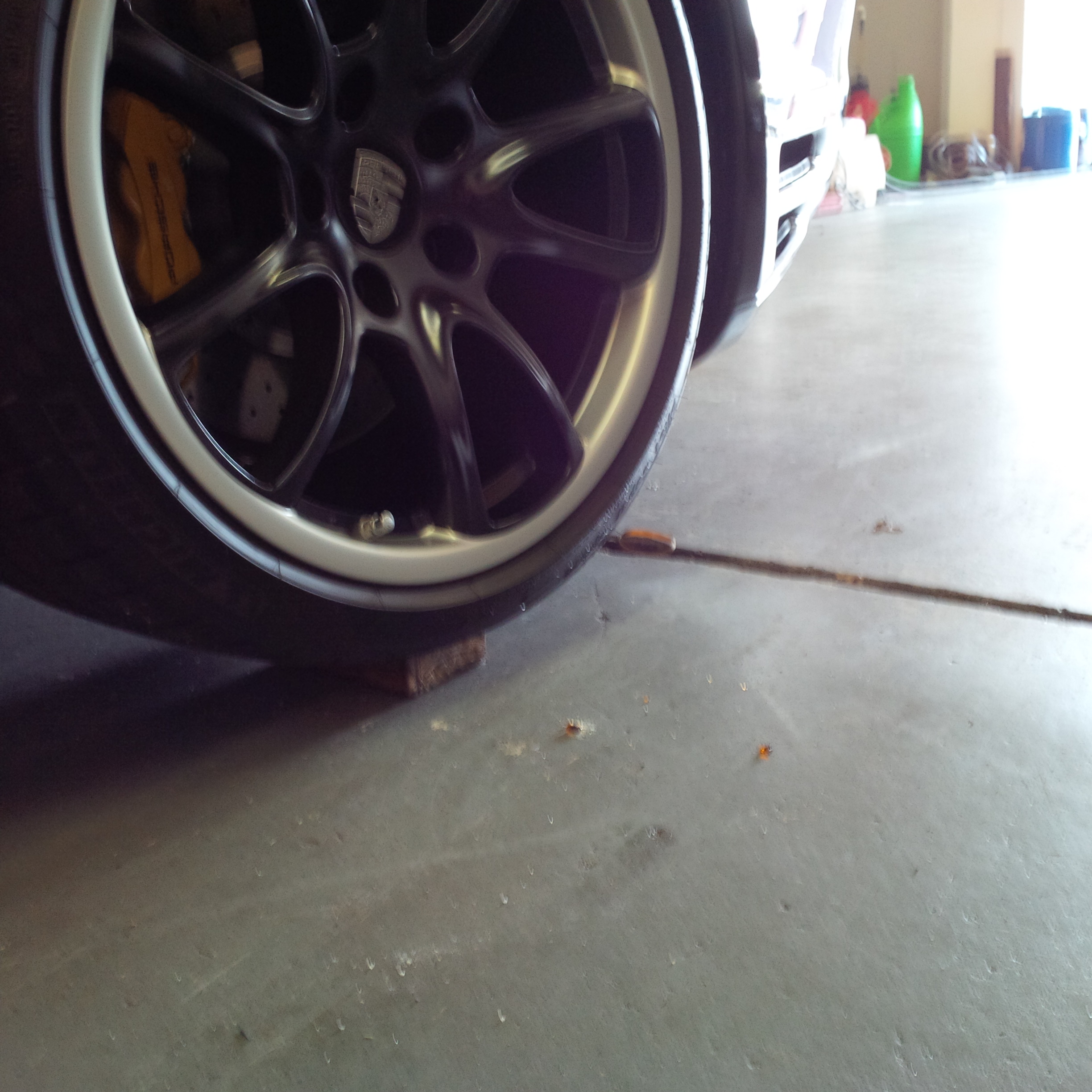

yup 305 30 19 michelin supersport. must be the angle of the picture.. michelins are plenty meaty.

Agree, def lots of meat there on a PSS. Running same 305-30-19 in rears. Another angle for your reference. The sidewall is square on a 19x11 here.
