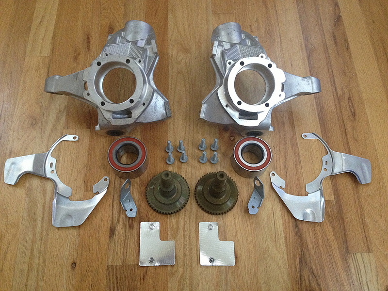

These are the pieces to convert the front suspension to GT2 spec. Different front brake rotors are needed as the GT2/3 offsets are different from the TT.
what did that bundle of parts cost?
It was right at $1400, give or take...
