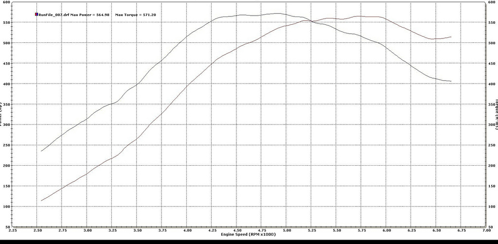

Just wondering if anyone has tried to find the max power per gear via a dyno and setup a shift light and set that particular rpm for that gear via the shift light for racing??
I know it may be extreme for most. But I was just wondering if anyone has done something similar. I see a lot of higher power dynos with big dips before redline which in reality would make the car slower while racing by holding it to redline as suppose to shifting at the top of the power band.
So lets say you raised your rev limiter and its now 8k but peak power is 7100rpm in a certain gear which matches the next gear power band. So instead of shifting at 8000rpm u obviously shift 7100.
Below is an example of a modded 996tt. Stock Rev limiter.
The difference between shifting at 6000rpm and 6750rpm is nearly ~100wtq and ~70whp.
Just something I have been pondering. Seems there are some guys that can drive and some that aren't as good, guys running 9's per say which is somewhat rare on this platform. The guy from USP I believe (chris green) who runs nines and I see people consistently saying "he can drive." But also knowing the best shift/power points would be most important?? Any thoughts?

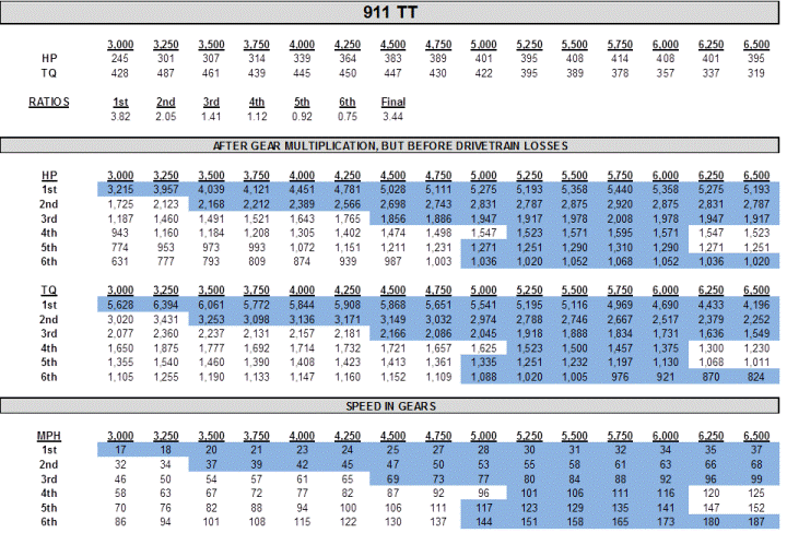

Here's a little chart I worked up for a stock 911TT.
As you can see, buy the blue areas, you would shift when your making more torque (to the rear wheels) in the next gear than staying in the current gear, or when you hit redline.
Basically shift at redline in 1st through 3rd and then shift at 6,000 for 4th and 5th.

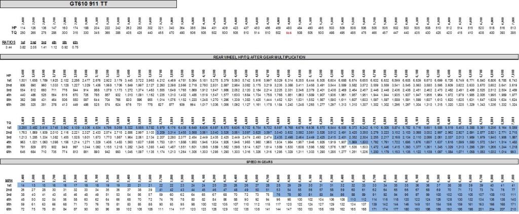

Here's one I worked up for my GT610 with a 7,000rpm rev limit.
On this chart I use wheel hp/tq number versus engine hp/tq on the other graph.
Later, Steve
Later, Steve
Added Rep points to you buddy!!! Nice going.
