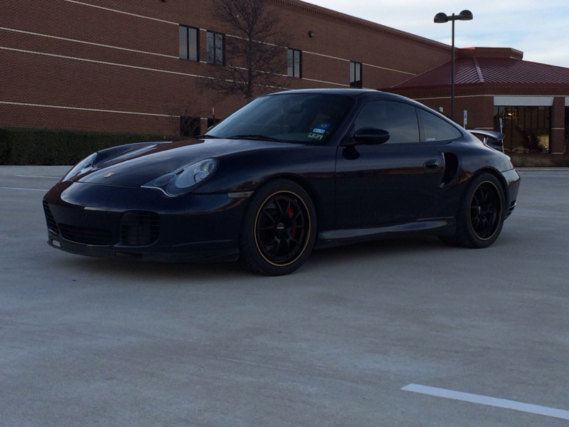

Got them on.
Toyo r888 335/30 18. Massaged the liners a bit and rolled the fenders. Not terribly hard.
With the spacers I used the offset ended up at 43mm
My front wheels with spacers are 18x9 with a 40mm offset. I'm thinking about going back to 45mm
Any thoughts on what the better 18x9 front offset is?

Here's another.

Stilov, any pics from the front and back ( straight on )? Car looks good BTW.

Ill get some tomorrow.
I feel like the front poke out a little more than I'd like. (I have 12mm spacers, thinking about going 7mm)
I like the way the rears look. (I've got 12mm spacers, but thinking about bumping up the 15mm to get a hair more inner clearance. I think I have room too)

Here are some shots of how they fill the wheel well
ID:	334525   Click image for larger version

better get some clear protection on the rear qtrs. the sand the rubber is going to toss up will eat the paint right off that car
