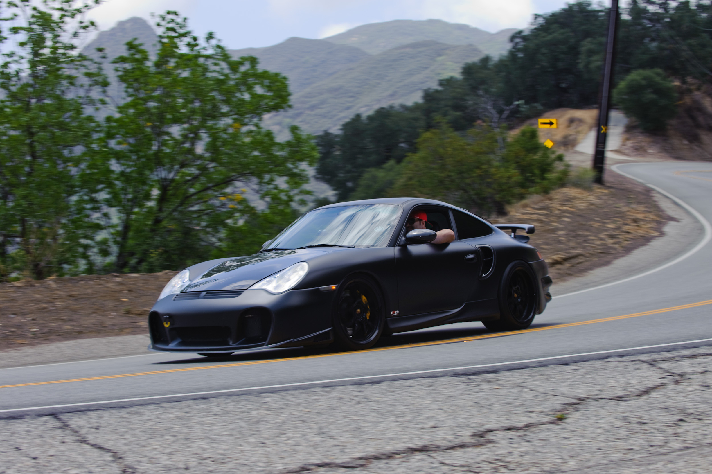

We ran the cars on the Dyno Jet this past saturday at European Auto Source(EAS) in Anaheim CA with the ShiftSector crew. My car with the Protomotive tune, 3.8L Mahle upgrade, complete push through setup and IPD's latest dimpled custom Y-Pip and TB with meth injection made the following numbers with 1/2 tank of 91 Octane, 5 gallon MS109 mix along with 100% methanol spray.
PSI 29.04
851Whp & 857Ft lb
See dyno graph attached... Oh and yes it can be done with Alpha28's!!!

Wow, must be like getting shot out of a cannon. Great looking too. Well done sir. Well done!
