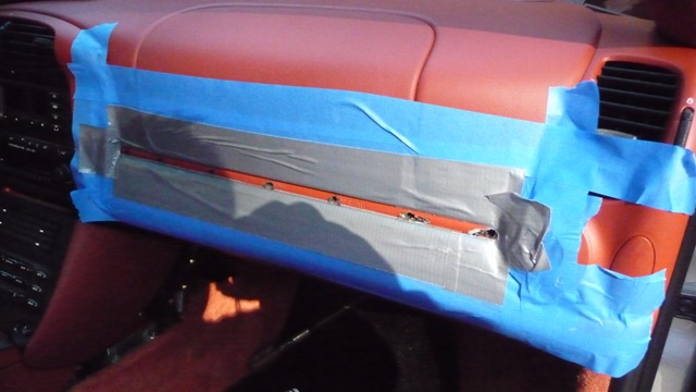

I did mine by using a solder gun and heating / pressing the screws out. Mine is an '01 so no glove box removal access. It was a little nerve racking but with patience and plenty of time it was pretty easy. Gotta admit a wrap sounds quite easy and should be less complicated with opening up a lot more possibilities.
ID:	330791   Click image for larger version
