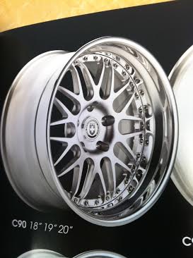

mpgandco, I will be running with the PS2's. Looks like it is Pirelli PZero Rosso's and the 888's are the choices in our sizes now...... at least that is what I see on Tire Rack.
My wheels are ordered.

I went with HRE C90's. 8.5x18 ET47 and 12x18 ET43. I'm lowered on PSS10's with new PS2's. No issues at all with rubbing. Did not have to roll fenders just load and go!

Car looks great!!!
