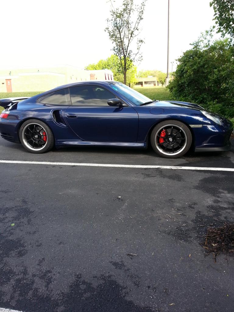

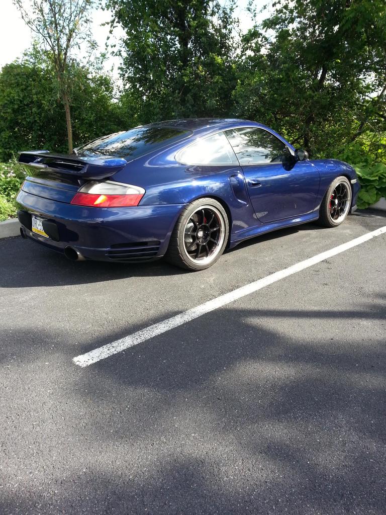

Just put 50 miles on them. height set and alignment completed.
I have them set 30 front and 30 rear. The front felt a little bouncy so just reset the fronts to 25. We'll see how it is tomorrow.
Old Jun 26, 2014 | 05:08 PM
  #48
geetee's Avatar
Joined: Apr 2006
Posts: 1,346
From: 19454
Rep Power: 90
geetee has a brilliant futuregeetee has a brilliant futuregeetee has a brilliant futuregeetee has a brilliant futuregeetee has a brilliant futuregeetee has a brilliant futuregeetee has a brilliant futuregeetee has a brilliant futuregeetee has a brilliant futuregeetee has a brilliant futuregeetee has a brilliant future
25.5 all 4 corners. This is with gt2 size tires 315/30 and 235/40
If I go back to stock tt size 295/30 and 225/40, It'll sit at 25.25 all 4 corners.
I've put about 200 miles on it now....feels good so far. Still playing with the stiffness
