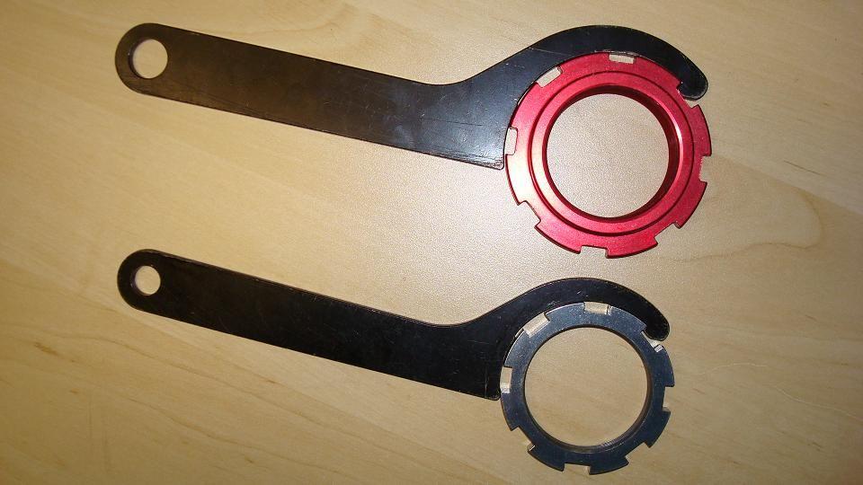

It'll look something like this I bet:
It's a specialty wrench. They "forgot" to give it to you?

Originally Posted by geetee
The kit came with 2 wrenches...you really do need them. Makes it very easy to turn. If you can spin/rotate the springs with your hand, it's too loose.
Loosen the bottom perch on the spring. Hold the spring with 1 hand and tighten the top perch with the wrench. You'll start to feel the resistance. It's very difficult to overtighten. Check to see if you can spin the springs with your hand. Once the springs are pretty snug, tighten the bottom spring perch against the top one.
Is it essential to hold the spring? If you don't, it looks like the part on top of the spring spins with it. Not entirely sure what that does??
