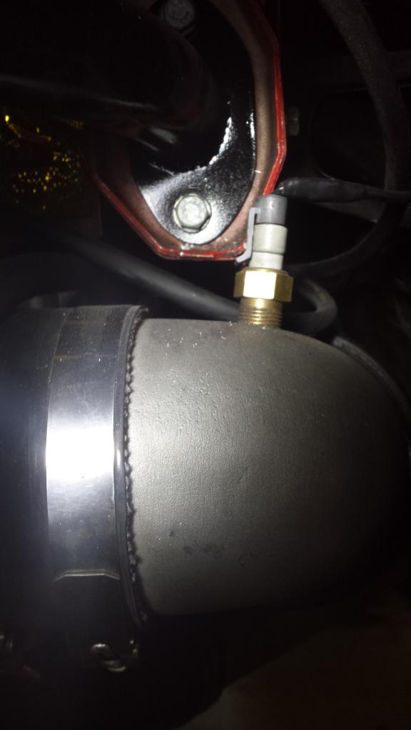

Pre turbo air temp sensor.
Post turbo temp sensor.
Intake air temp sensor, or post intercooler.
Those are my sensor location and my data acquisition is done by,
Motec M880 fully enabled $12k plus.
Motec CDL3 fully enabled $6k plus
Markski,
Can you list and show what you are using for your data acquisition? I will not discredit your 9 second run even tho it has not been backed up and even when you tried to you fell in the low 10's. As you said 100's have tried, myself included. After the roll race in Pocono I will hit the 1/4 now that I have a certed 8.50 cage and I can get my time slip.

Yes Mark, you are right.. meth will make everything perfect when it kicks in... I dont remember exactly, but my 4.5" ICs and filters above them, running pump without meth even in crazy summer heat (30-35C or even more), IAT is staying bellow (but close) to 50C where i know ECU starts retarding timing a lot.
A better system might squeeze a bit more performance in warm/hot weather imo, installing meth is game over tough... everything looks perfect, even much better than running ms109 only
By the other hand, having those sensors is a nice to have, thank you for explaining everything, looks like a nice setup... i should upgrade to Syvecs at the end of this season
