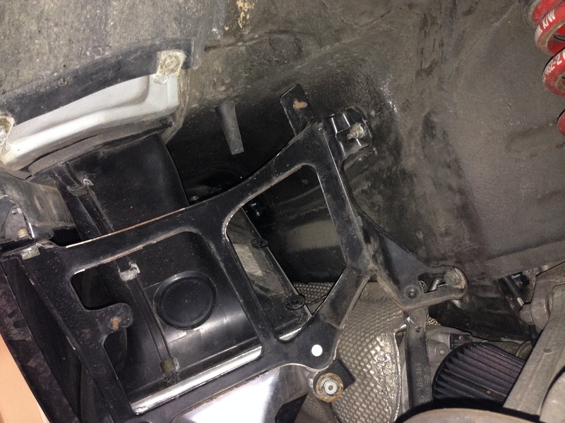

I don't claim to be an expert on this stuff, but I do have some data on my own personal experience. I'm just an enthusiast looking for the best solution, and hopefully my dicking around with this stuff can help someone else make an educated decision on what they want to do with their car. I'm not trying to sell anyone anything, just here to help!
That being said ; there is no perfect solution for this. Each of these options come with sacrifices. Throw the filters on the those and you have plenty of airflow, additional spool, but a large rock could come through that filter and cause some damage quick. The filters get dirty quick, but if you want max power (for the track / strip / whatever) this is probably the way to go. If you get stuck in the rain ( a GOOD rain ) be prepared to pull the car over unless you want to chunk a motor.
You can run a flexible intake pipe, which is a little easier to work with, but space becomes an issue, and restriction on the inside of the pipe as well.
You can make / buy / build a hard pipe setup, which has less restriction than flexible intake piping, but is harder to build, harder to fit, and clearance again is an issue (from the tire and the chassis / suspension over large bumps).
For the other enthusiasts here, my personal situation is wanting a car with great power / torque and to keep the block together. Some tuners say 600tq is the limit, some say 650, some say 700tq...then of course what dyno are we talking. While power IS important to me, keeping the motor together is more important. I really didn't want to run the filters on the turbos because of a close friend losing a motor to a torrential down pour, but we don't mod these cars for our health, we want the power we paid for, so thats important as well.
Here's option 1 : Filters on the turbos. Quick spoolup, sounds awesome, gotta be careful about rain and rocks, most people run pre-filters. Car felt the fastest like this. note how filthy the turbo is, and I probably drove only a few hundred miles like this.
Next option, move the filter up and above the intercooler. Do you just tuck it in the little cavity behind the intercooler ducting knowing that it probably doesn't get fresh air, or do you modify the ducting to allow air to hit the intercooler?
cavity :
modified intercooler duct:
*image courtesy of vivid tuning
Realize if you cut a hole to the intercooler duct that air will take the least path of resistance and not go through the intercooler unless you block it off (what Markski does with his intercoolers).
so if you DON'T do this...air isn't going to go through the intercooler, it's just going to go around.

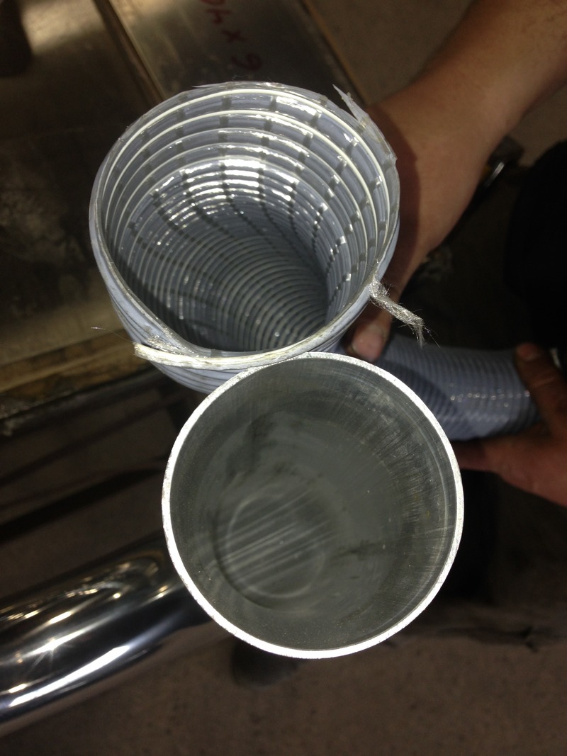

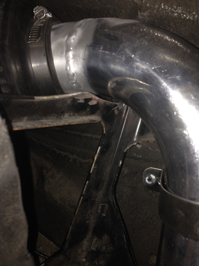

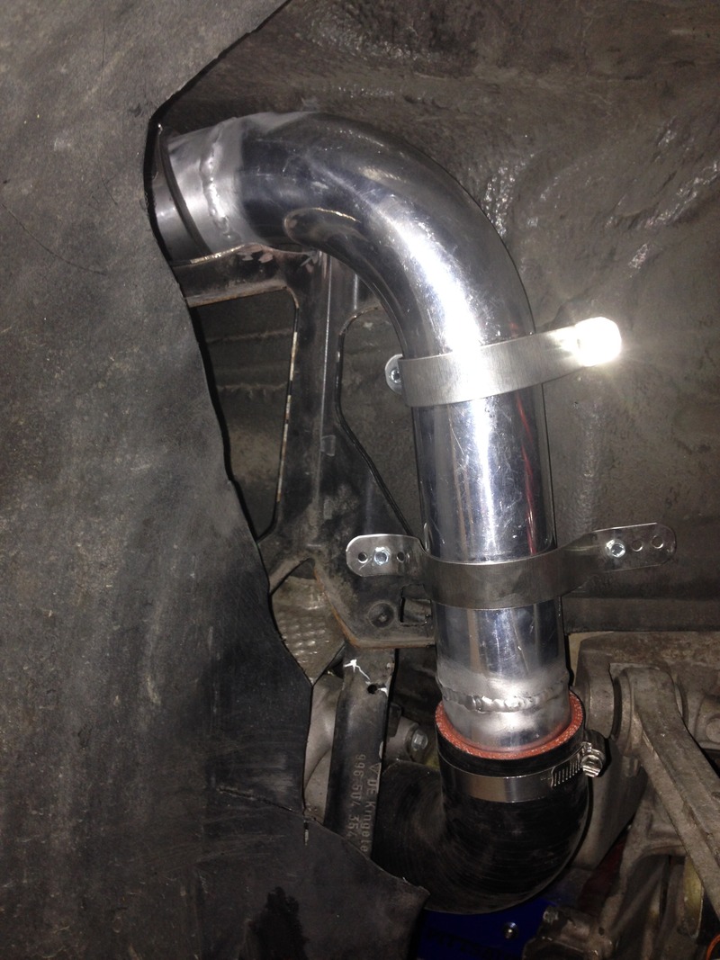

Once you decide on that, you need to decide what you're going to run. Flexible intake ducting or fab something up from aluminum? Aluminum dissipates heat really well and is stronger than the flex stuff BUT harder to fit, and build. Here was my setups that I tested :
aluminum 2.5" piping :

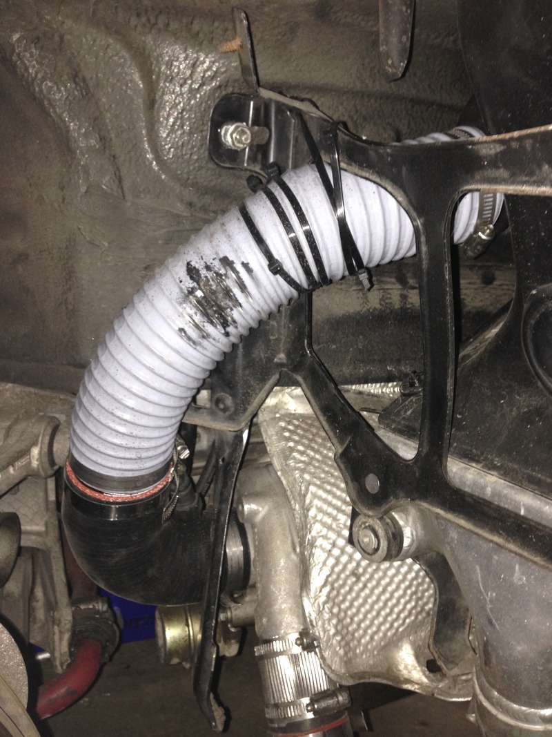

the hard part about THIS setup is that unless you have to worry about A. the piping hitting the tire and B. the pipe hitting the chassis / intercooler bracket. I tried to remove as little as possible on my first mock-up...which is where the car currently stands now. The intercooler bracket is the only thing that's been modified. I've put 200 miles on this setup and haven't hit it once on the wheel tire (while driving extremely aggressive), but am running an aggressive offset on my rear wheels. In fact, switching from a 315 / 25 to a 305/30 now causes tire rubbing on the fender liner on larger bumps. I will also say that when I hit a large bump i can hear the aluminum intake hit the chassis (not a great sound).
I originally tried running the flex piping lower, but had issue with the tire rubbing the tubing under hard cornering :
when I added the clamp and routed the tubing higher i had no issues with the tire rubbing even under hard cornering :

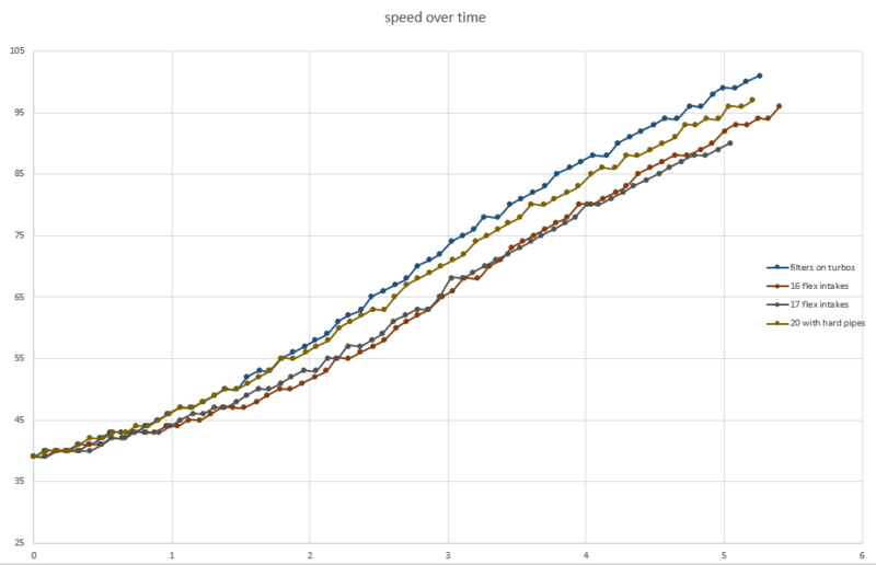

so what about numbers? WELL. the car was tuned with the filters on the turbos, and then I tested the flex tubing, then the aluminum intakes, and then was re-touched up since the air flow was modified.
Here is a speed over time graph I made from 3 logs comparing filters on turbos, to flex tubing, to hard tubing.
Now don't jump to conclusions too fast, because the added air restriction actually lowered the boost a little bit. Could we have raised the boost to compensate? Sure. But it wouldn't help with spool time.
So what am i going to do? Probably keep the aluminum fender intakes and find a way to make sure they never rub or clunk. The question is, can the chassis be modified a pinch (cut out / punched in) so the pipe can sit 1/2" closer into the car so help with the clearance.
