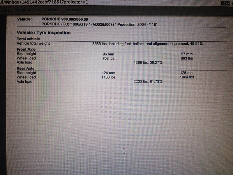

Install GT2 rear fender liners and brackets. These will give you a bit more room down by the IC hose because the fender liner attachment point is relocated to the side. The TT/GT2 fender liners are the same part but the GT2 ones have a hole in the side for the bracket. You can take the TT ones and drill hole in them but they are priced about the same. Check your rear wheel offset. On a 18 or 19x12 wheel ET40 works like a charm using 305/35/18 or 305/30/19 tires. That's what I run and I'm at 96/124mm ride height (about 1/2" below GT2). Rear fenders are rolled on a GT2. Have your TT fenders rolled for more room.

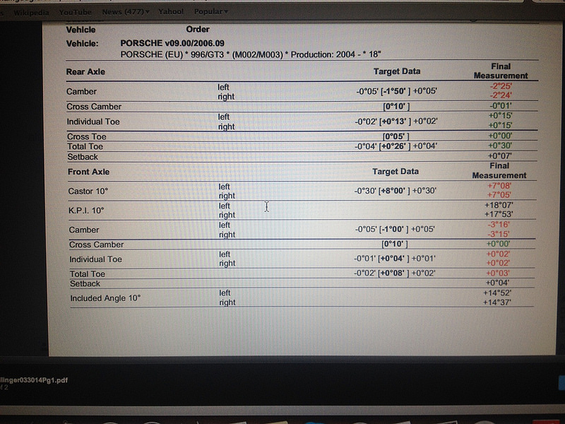

What is your tow alignment? I was doing the same until I put .25 tow in each side

0.15' per side, 0.30' total

Jon are those measurements right? It seems like some are in degrees and some inches? Or is my too tired brain reading it wrong at almost 1 in the morning?
Hey Scott. No, those are degrees and minutes. The way Porsche and others spec alignment number is in degrees and minutes (1º = 60'). All you need to do is divide whatever minutes you have by 60 to convert to degrees. For example 30' = 0.5º (30/60=0.5). If you look at my front camber of 3º15', that equals 3.25º. My rear camber is 2º25', which equals 2.42º. Hope that makes sense.
