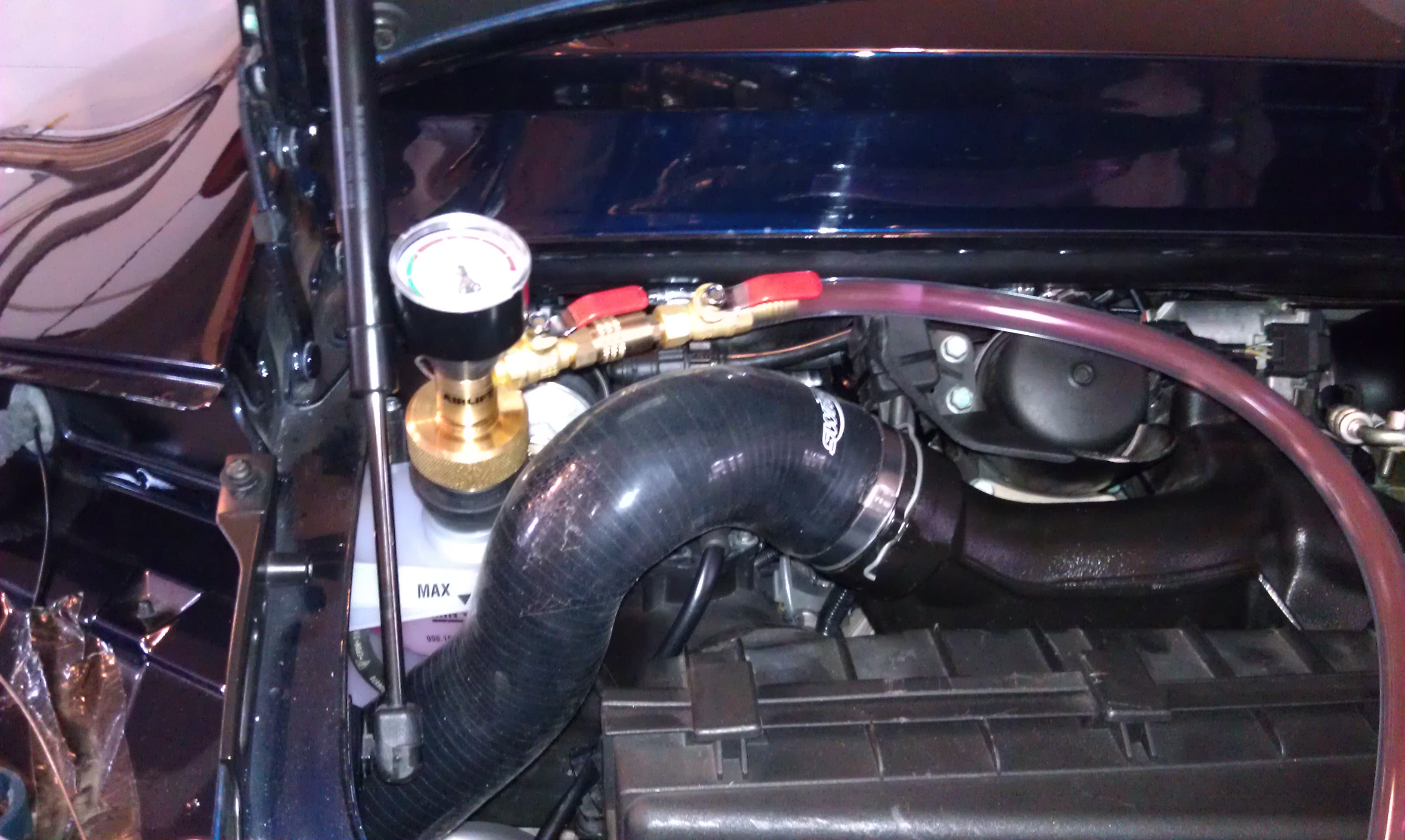

Did you use a vacuum coolant tool?
These tools are cheap and really easy to use. IMO the only way to fill the system.

i have used the vacuum tool and it still does it.
