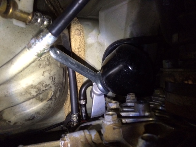

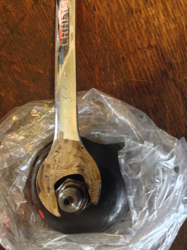

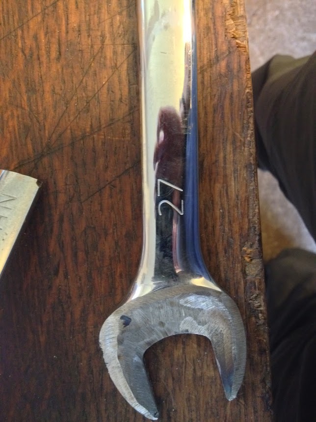

Some people have reported that using a strap wrench worked on the accumulator. Common enough at the auto parts store.
I had to make these:
The original was 22 mm
Replacement was 27mm

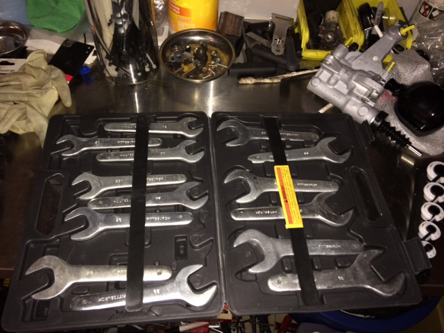

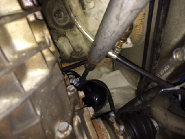

I picked up the shorty wrench set suggested by DaveSen at harbor freight, the 27mm worked great!! Put the cheater bar (floor jack pole) and cracked it loose. Right tool equals quick job. I didn't go any further since I just wanted to try it to make sure it worked and report back. Hopefully I'll have some more time throughout this week to finish the job. The link for the wrench set is a a few posts up, part number 93668. It actually is a black box as DaveSen mentioned, though the link shows red.
