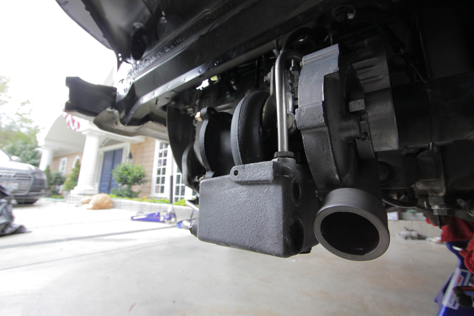

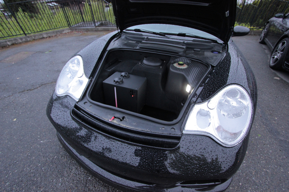

Hello Everyone,
I'm starting a build thread to post some updates, and pictures, of my build. I started about 5 weeks ago in my garage, with my buddy (LQQK on these forums), and now I have my first dyno results (below).
I got most of my parts from Sam @ bydesignauto. He's a great guy to work with, and highly recommended.
Setup -----
- Gt2871r Turbochargers
- Walbro 450l/h Fuel Pump modified into the OEM basket
- 80lb Injectors
- Protomotive Tune
- GT2RS/997.2 Intercoolers
- Aquamist Methanol Injection, running 100% Methanol
- Custom 3" exhaust w/ 100CEL cats (cats are only rated for 300hp, 150 on each side. I used to have two cats on each side for 600hp, but I removed the first set...)
The fueling system is based off of the DIY tim wrote on dropping a walbro pump into the OEM fuel basket, however the gt2 had some surprises. The gt2's basket was completely different than the turbo's setup. The sump that the pump sat in wasn't even the same idea. The pump system also had no jets. This explains how the gt2 gets more stock fueling than the turbo. We fitted the pump using the walbro's fuel sock (you can see it in the basket in the photos below). I can post more photos of the fuel system upon request.
My firsy dyno video is below the pictures. The car made (Uncorrected) 577rwhp, and 605 rwtq @ 1.3bar. I think my exhaust is restricting the top end. I hope to just break 700 at the crank when all my tuning/modding is done. I'm going to gut my cats and see if I can get that restriction away.
Here are some pics:
