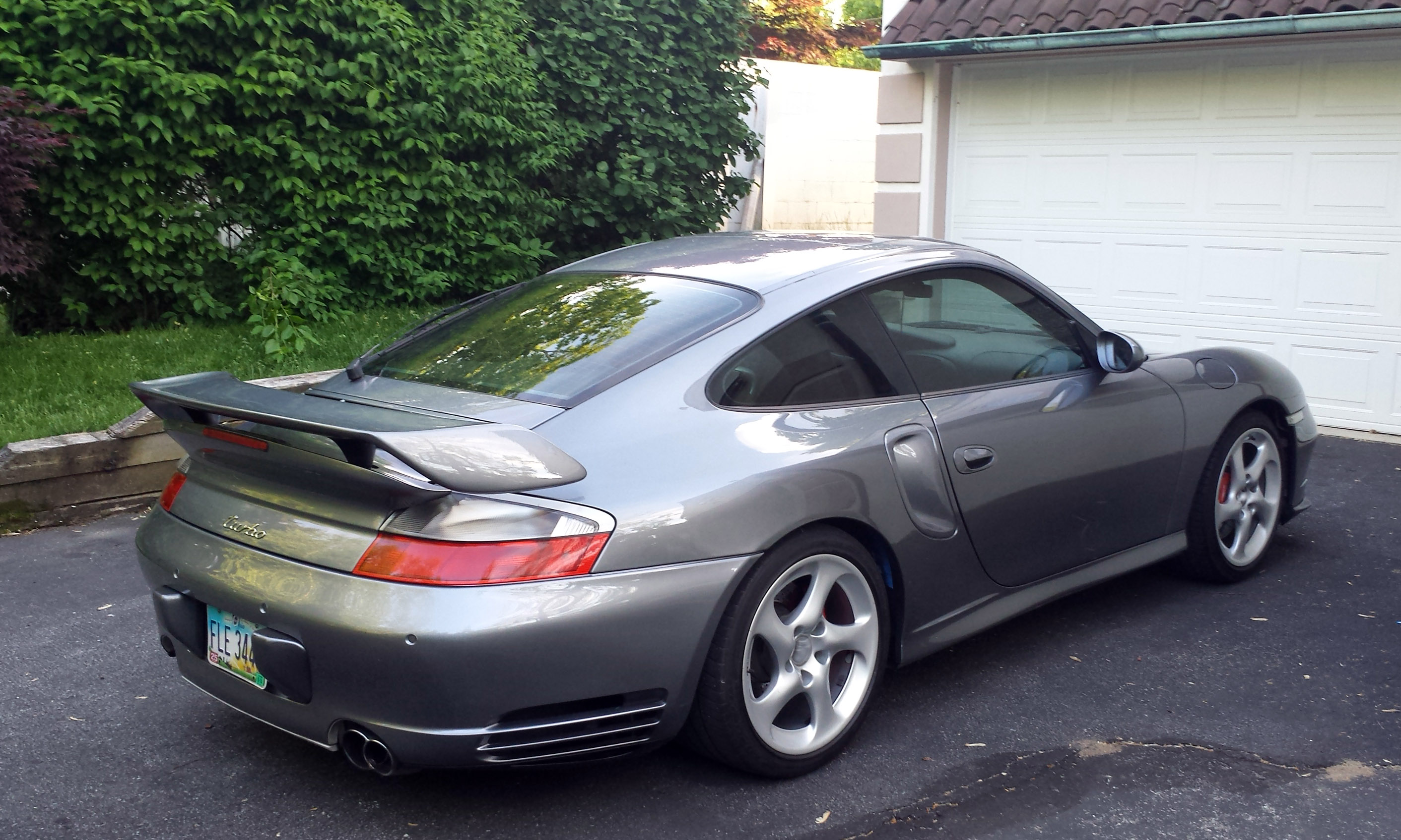

Here is my thoughts, I drove one other 996TT before, here in Columbus OH and while it had 83K miles and was in severe need for maintenance (ABS fault, nearly dead clutch, engine rattled at idle like can of nuts and bolts....), it pulled at lower rpm better then my princess.
My boost appears at 2300rpm +, but ever so slightly, however at 3500+ she explodes and I flies like a rocket. I am thinking that this can be tuned for a bit flatter curve, where I get to enjoy the entire rpm range.

I'm not understanding what you're asking for... To me it sounds like you bought a car that is already tuned, you want to know if it is safe or if you should go back to a stock tune.
Your last post sounds like you want a re-tune.
Either way, the difference you're feeling between the two cars could be a number of things. Some examples:
1. stock vs x50/gt2 turbos - the x50 turbos would produce more power at the expense of increased lag.
2. boost or exhaust leaks
3. condition of plugs/coilpacks
4. wastegates
5. differences in exhaust/intake
A few pulls on the dyno are not at all taxing for the car, as long as the rollers are setup for the Porsche awd system.
You may be able to retune to get a bit more low-end, but it would probably be at the expense of the top-end.
Turbo blankets and a free flowing exhaust might get you the low end you're looking for.
