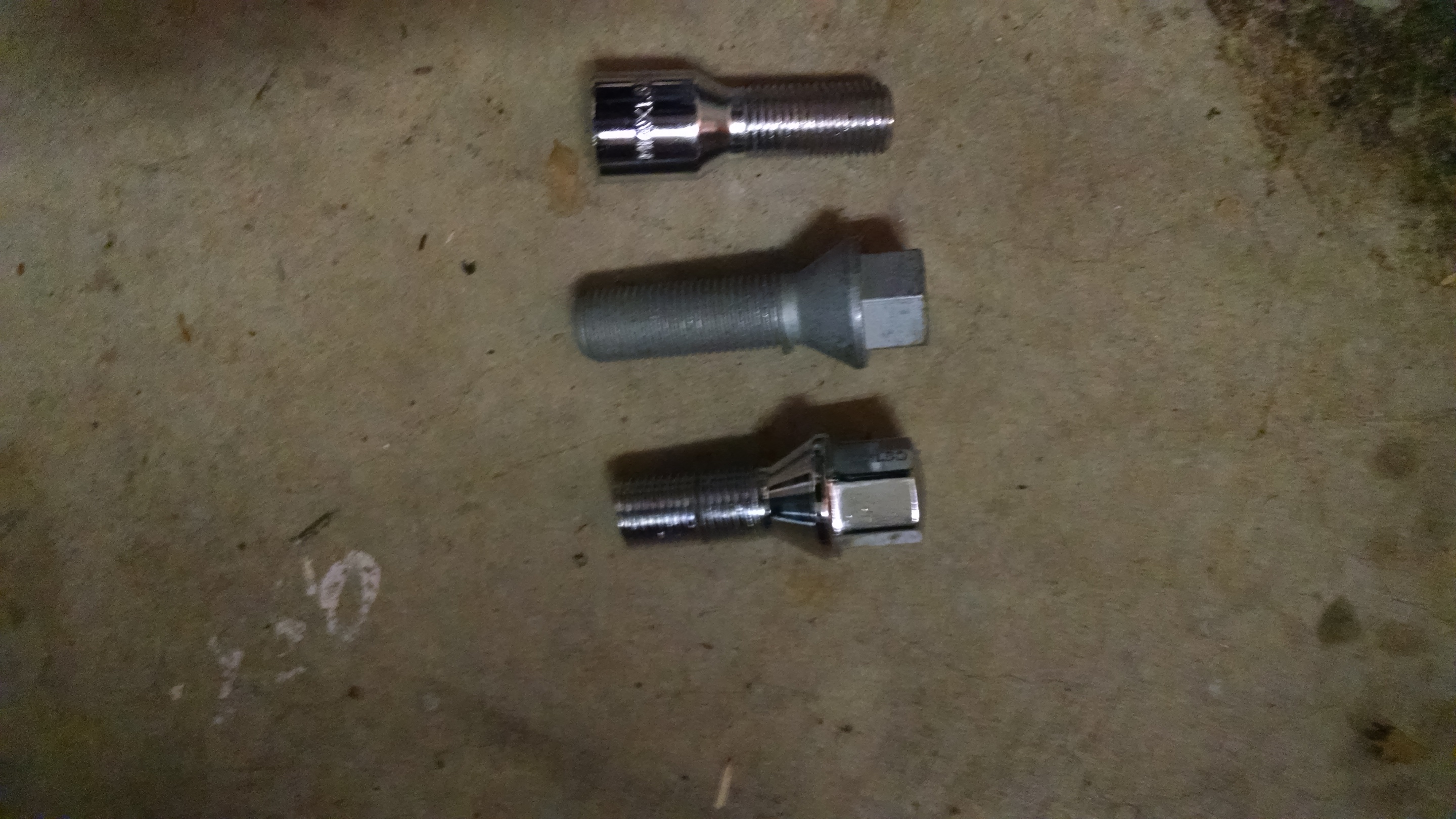

solution: 17mm x 14mm x 1.5 x .41mm TUV certified dacromet coated with a thin wall socket torqued to 100 ft lbs. they're snug as a bug in a rug.
shout out to wheel enhancement in LA ( 6spd sponsor? ) for knowing wtf i've been talking about and realizing the my issue was just plain old lousy *****y lugs and to OTIS LA ( also local ) for having them in stock at a reasonable price. this has been quite the odyssey but my journey and dllemma has been sorted. thanks to all here for their advice re measuring etc etc.
look at that sh*t i've been using ..sheesh. it's no wonder

so is one of these the final lug bolt? which one?

I'm betting the gray one!

lol. fellas it's approximately 1MM too long. hitting the e brake. i'm only the piano player but shoot me anyway
cant friggin believe this ha! sorry for the update. grr.
machine shop. machine 2mm off. you will be fine. was it the gray ones? i think i mentioned something about this
exactly! what we're doing. guy at otis bolts is taking them himself. no ones fault really. can you imagine i dont have ONE freakin MM of clearance ridiculous, really.
yes, the gray. they are tough lil suckers. german for sure.
you probably did steve. i had to measure, and talk to folks.. and this is what i got. wrong! lol

was always an issue with the m/b when i was changing rims to get the right length and not hit the ebrake. makes studs look better and better
make sure the roll the edges so it doesn't cut the hub threads when installing them. they should be harder than the hub threads. easy to screw the threads up if not rolled edges
