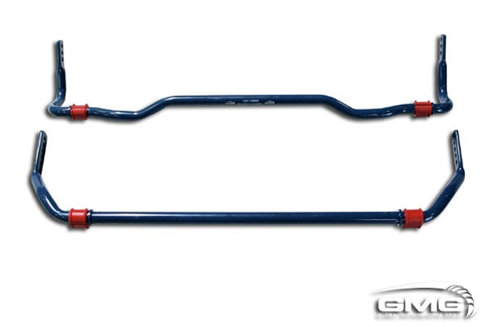

Since the GT3 rear swaybar was adjustable, I thought I would first move it to its stiffest setting. Unfortunately the previous owner had installed the bar without changing the drop links, so I first needed to change to longer drop links. With the drop links changed and the swaybar set to its stiffest setting, my rear wheel rate percent went to 48.4%
The change was noticeable, but only slightly. It definitely felt like I was going in the right direction, but just didn't take a big enough swing.
At this point I began looking for something to get my wheel rate percent in the high 50's to low 60's. This could have been done with new springs, but the PSS10's already felt on the edge (given the pogo effect over bumps), so this would force me to change coil-overs or revalve my PSS10's.
After getting some information and doing the calculations, it appeared the H&R rear swaybar was going to get me the closest. It's a little larger in diameter, but the huge stiffness increase came from it being solid versus the hollow GT3 bar. Adding the H&R rear swaybar (at its stiffest setting) would move my rear wheel rate percent to 55.3% with no other changes.
I contacted H&R's technical department to discuss the setup and they gave me the green light, but other experienced 6SPO members warned of excessive over-steer.
After installing the bar, here are my impressions.
1. Still "floaty", but it now feels like I don't need such a large spring rate increase. I'm currently working with BMP Performance and Bilstein to see what we can do with my current PSS10's.
2. The tendency to "pogo" is significantly improved. I actually haven't felt the car do this anymore, but that doesn't mean it won't, given the right road. Either way, it's a significant improvement.
3. The rear heavy feel has almost completely gone away in steady state corners. The car does tend to get more unsettled than normal as the rear unloads, such as with trail braking or mid corner bumps. I'm not sure a novice driver would need or want this. Definitely manageable, but not what you would want to go fast on a roadcourse.
4. The car still turns-in nicely, though not any better than before, but the mid corner under-steer has improved significantly.
5. The tendency to push and then snap over-steer (not really as excessive as over-steer as much as the rate of rotation increasing) appears to have went way. This of course could return and be worse when it does, but I have yet to feel it since installing the rear bar.
I would conclude that this is definitely worth doing if you are using the car as a street car and have PSS10's, but it's still going to need some more spring to truly be a great street setup. I would not recommend this as a track setup as you would spend too much time easing the car into a corner where you need to trail-brake, or where there are mid-corner bumps.
At this point I began looking for something to get my wheel rate percent in the high 50's to low 60's. This could have been done with new springs, but the PSS10's already felt on the edge (given the pogo effect over bumps), so this would force me to change coil-overs or revalve my PSS10's.After getting some information and doing the calculations, it appeared the H&R rear swaybar was going to get me the closest. It's a little larger in diameter, but the huge stiffness increase came from it being solid versus the hollow GT3 bar. Adding the H&R rear swaybar (at its stiffest setting) would move my rear wheel rate percent to 55.3% with no other changes.
