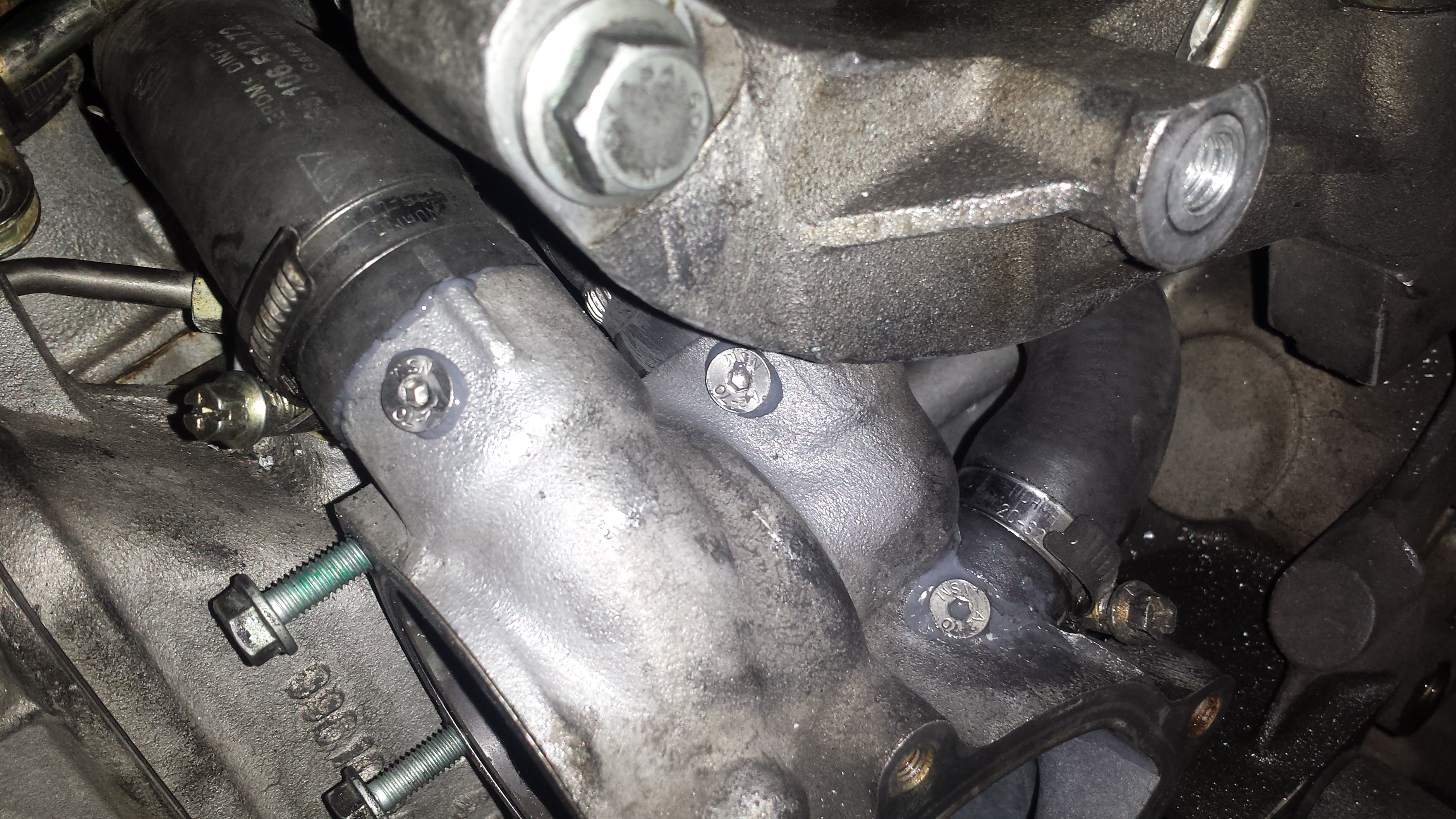

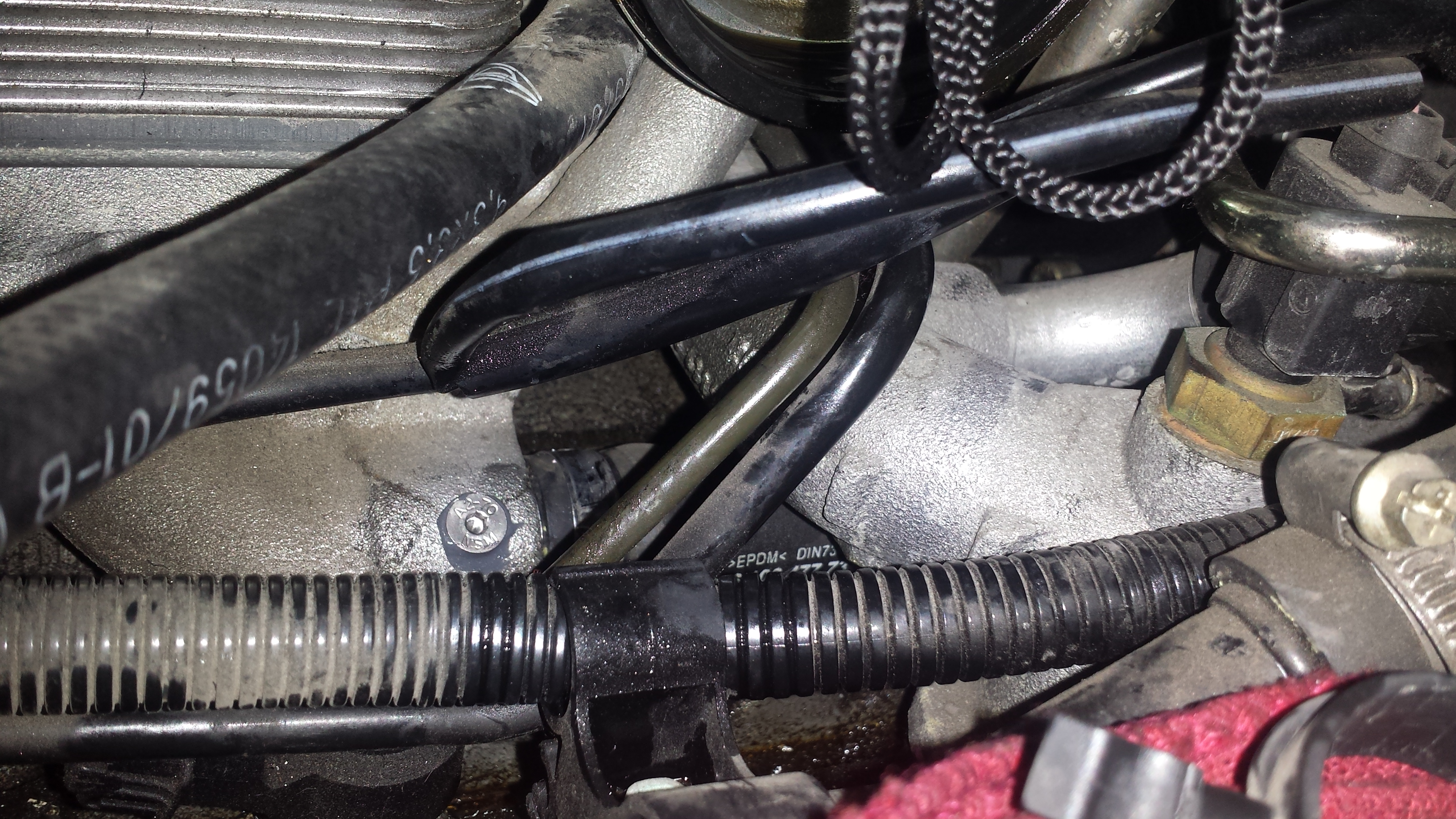

I did 4 out of 8 today, not an easy task, especially since I do not want to disassemble more than I have to.
