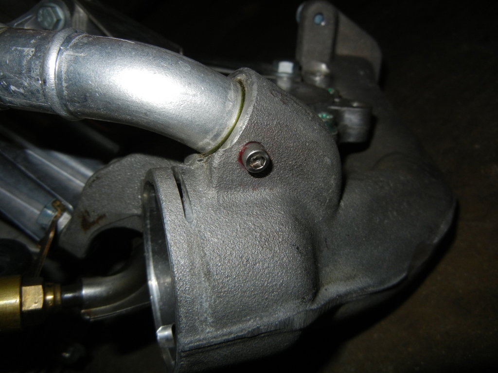

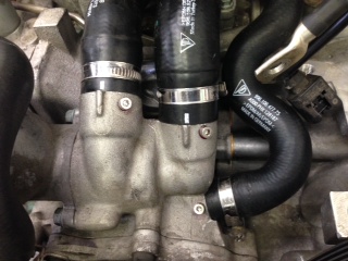

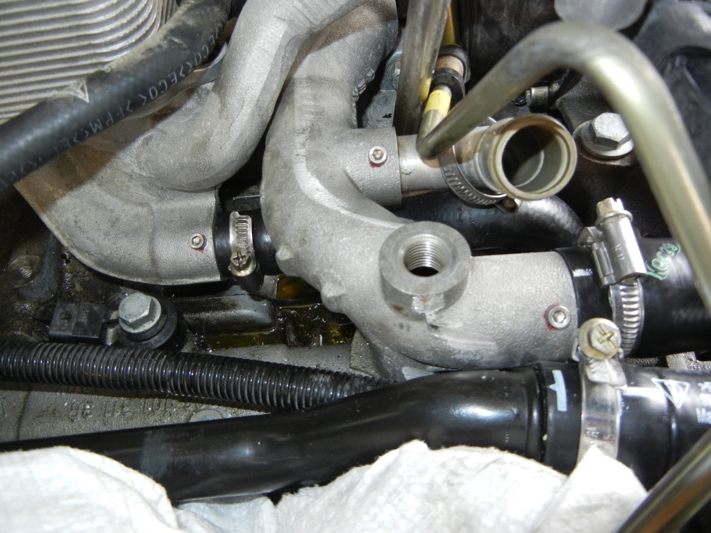

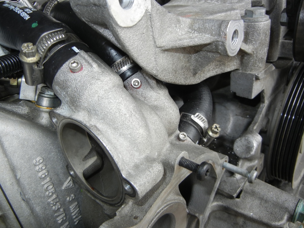

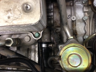

I pinned mine, replaced all cooling system parts(tank, pump, thermo., hoses, etc.), cam solenoid brackets, checked plug gap, bled clutch, etc.. lots to do while in there, I'll try to remember it all.
Also did new injectors, wastegates and EPL tune..

Originally Posted by p556guy
I think pinning is better than welding because the casting is porous and welding it right can be difficult.
What year is the car? If you're looking at 10 years I would say it's probably a good idea to replace all hoses (boost/rad) as well as doing a boost leak test.
Depending on maintenance history you might also want to do:
- diverter valves
- n75 valve
- fuel filter
- coolant expansion tank
- water pump
- thermostat
- belts and maybe tensioners
- spark plugs
- coil packs
- intercooler hose o-rings
- TB/plenum o-ring
- check your wastegates
- motor mounts
My timing sucks. I just had almost all the things done that you mentioned and then less than 100 miles later is when my pipe pooped out. Lucky me

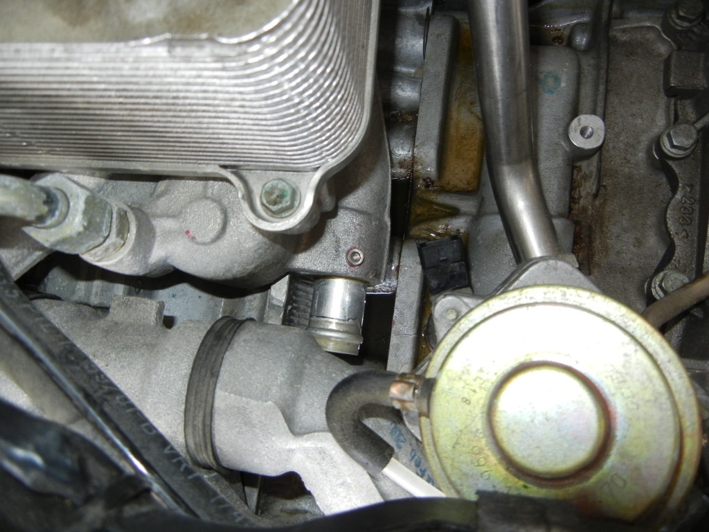

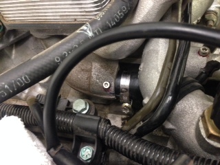

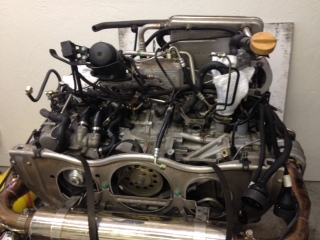

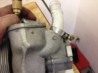

I recently had my engine and transmission out and I went with Sharkwerks pinning procedure I am glad I did because the same week my car was in the shop a GT3 blew its coolant lines. Since my engine was out these are the parts I replaced for preventive measures:
Awe Tunning 2.5 Sachs Clutch Kit ($1635)
New Oem 997 Transmission mount ($188)
New Fly Wheel Bolts ($27)
New Pressure Bolts ($29)
New Rear Main Seal ($30.43 mise well Transmission will be out)
New Clutch Fork
Oem 997 Engine mounts ( $318.44)
Pinning all Coolant lines ($580)
New Coolant Hoses
New Coolant expansion tank ($133.22)
New plugs ($47 will check coil packs if any cracks will replace if needed)
New Water Pump ($307.42)
New Serpentine belt ($84.04)
New Fuel Filter ($39.41)

I have a Tip otherwise a clutch would make a lot of sense. Has anyone considered the method in this video. they knurl the ends of the tub and then JB weld. They said that they do like to introduce any additional holes.
