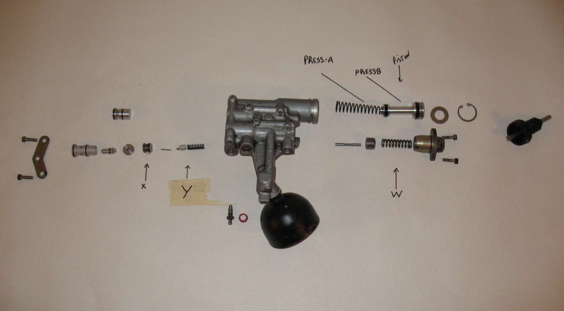

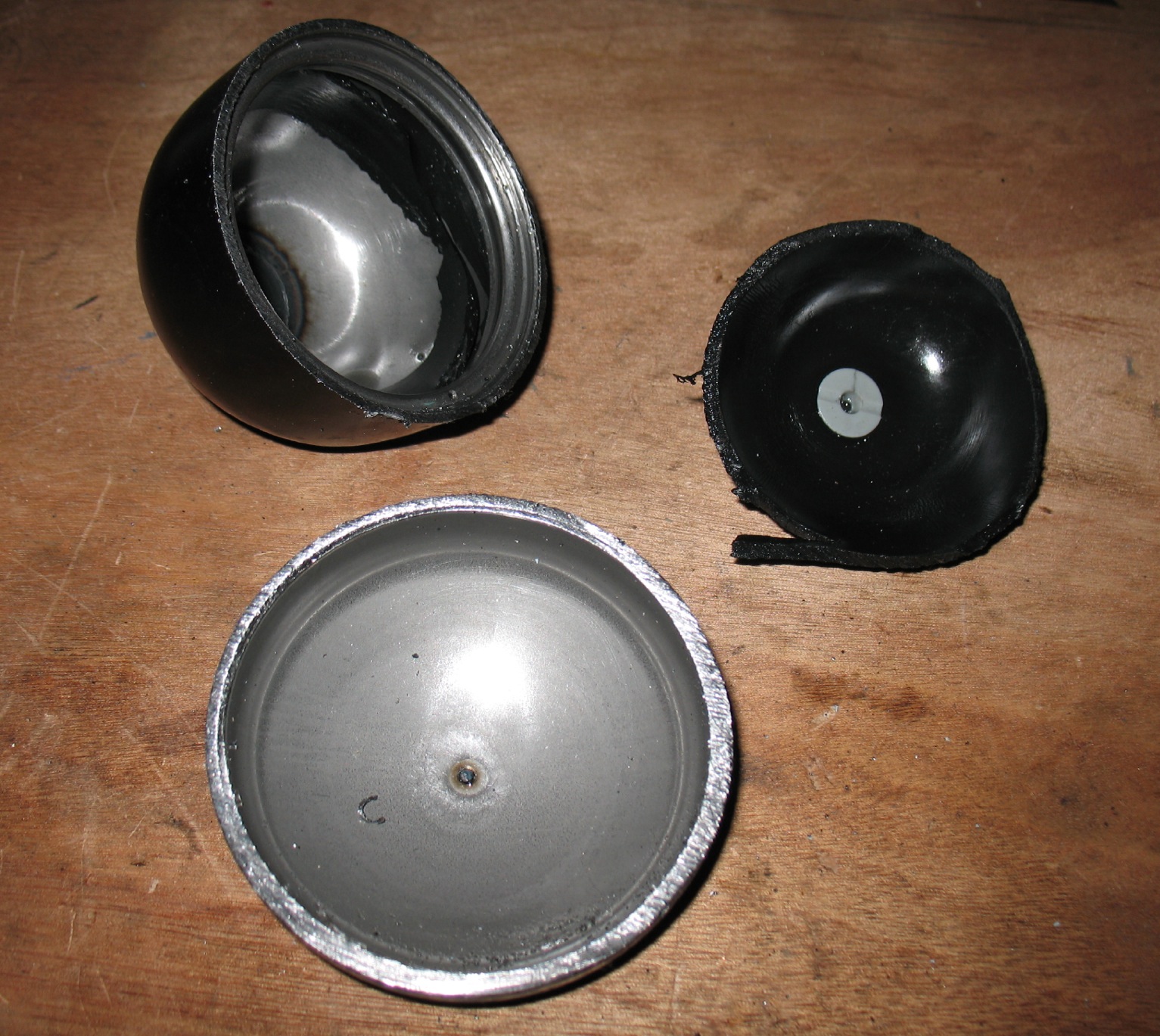

Yes in fact the rubber inside the accumulator seems to suffer from Pentosin. Did open one and found the rubber with multiple cracks. Also did a slave surgery and did not found anything obvious for the reason I had fluid migration.(front clutch reservoir overflowing) You can see the piston that operate the clutch on top of the picture has two sets of o-ring. I guess the smaller one is for the pressure coming from the steering pump and the bigger one is from the clutch pedal. The migration should happen in this area but both seals looks fine and the cylinder looks also fine….There is also some check valves and release valves that can be at fault but the function of these are still a mystery for me

^ I'm going with jpflips "failure is where the pentosin meets the rubber". Given their seeming dislike for one another the accumulator seems an odd choice for so critical a function. Of course it can be eliminated but that's something I've chosen to keep stock.
