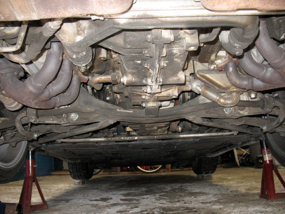

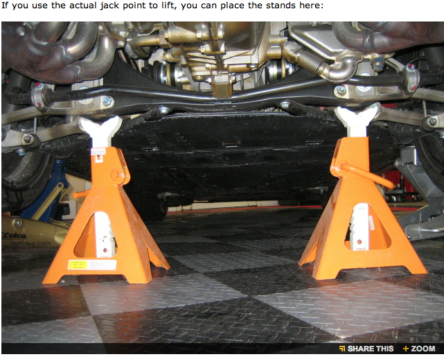

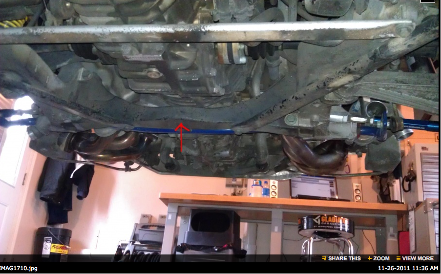

Jack up points
You can try this spot if your jack can go low enough...
I have tried the crankcase jacking locations many times in my , 996TT, old '79 SC and my old VWs and no problems...
Also, jack stand location options...
Good luck...

There is a spot right in front of 1 on a main cross member. Google it and you'll find that that is the best place to jack the rear. There has been lots of discussion on this on many forums. The spot on the motor will work too, but I think it will eventually screw your motor mounts. I used this spot to jack the motor to replace the mounts.
The harder question is where do you jack the front to get stands in place?
Contsaga, beat me to it.
