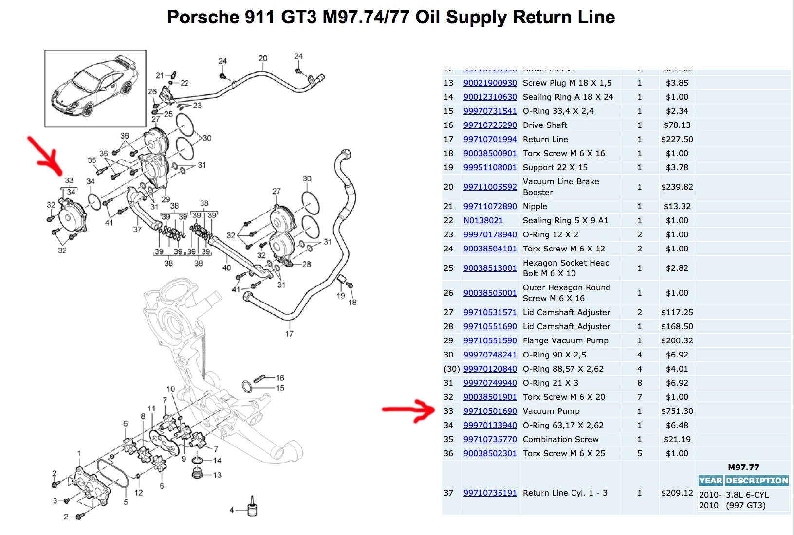

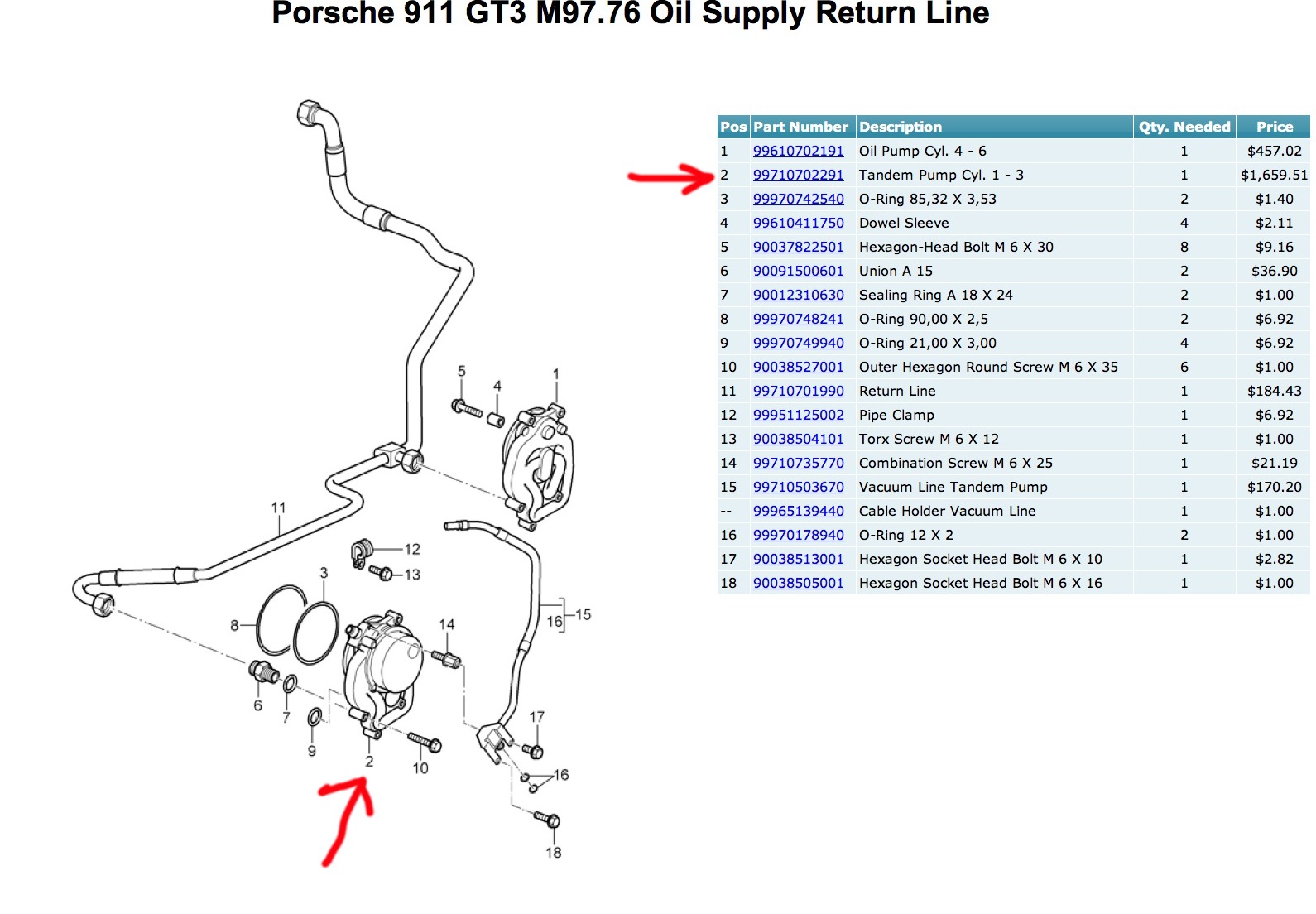

We learn something new every day!!!
Here's what I found in the parts cat…Very nice info, thanks for sharing….
The 997GT2 has a different part number compared to the GT3 presumably due to the different RPM capability of the two engines. That's the reason we went with the GT2 version.
Thanks for this clarification. I'm surprised of the location which is just besides the exhaust. Must be made of very specific material….
