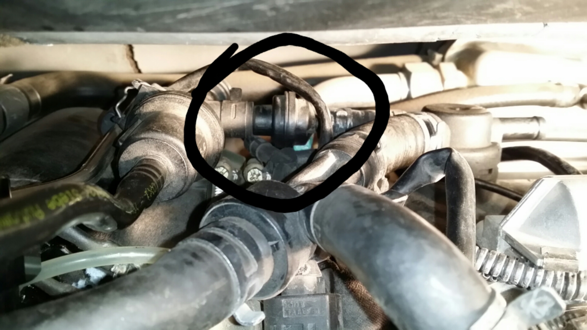

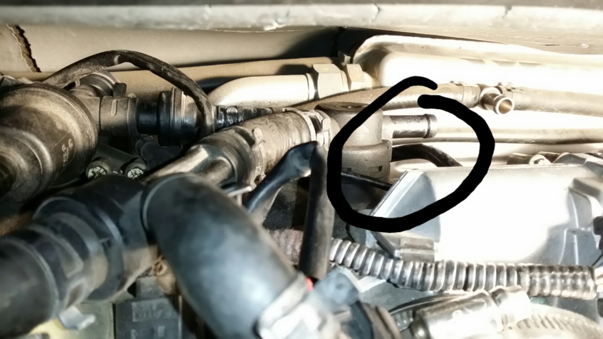

Still a boost leek ... the tube on the left has a built-in check valve and it was leaking a lot. I cleaned it out by spraying brake cleaner in it and then air and that fixed it. I am working on getting the small check valve on the left off. It is not holding pressure either.
