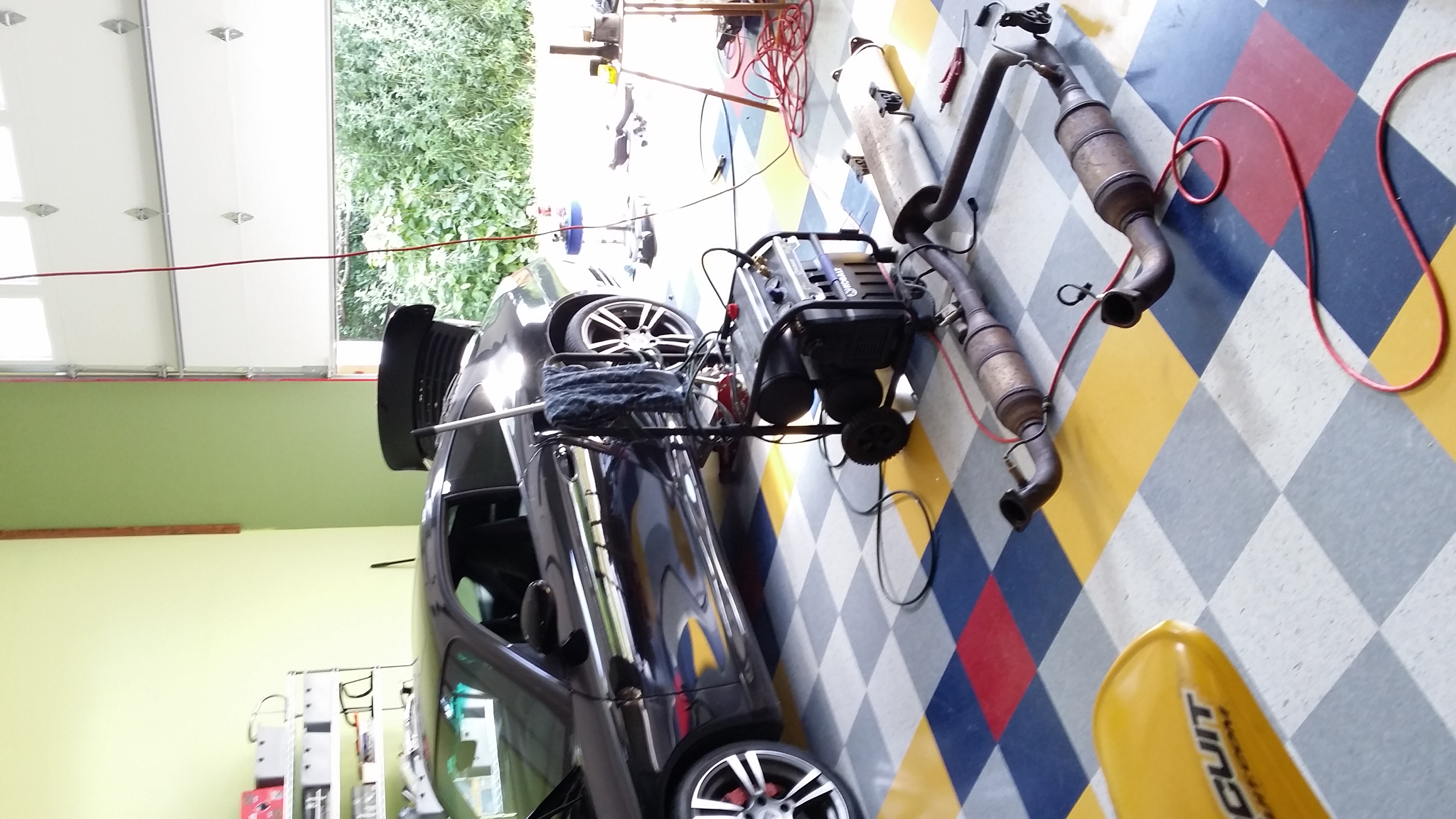

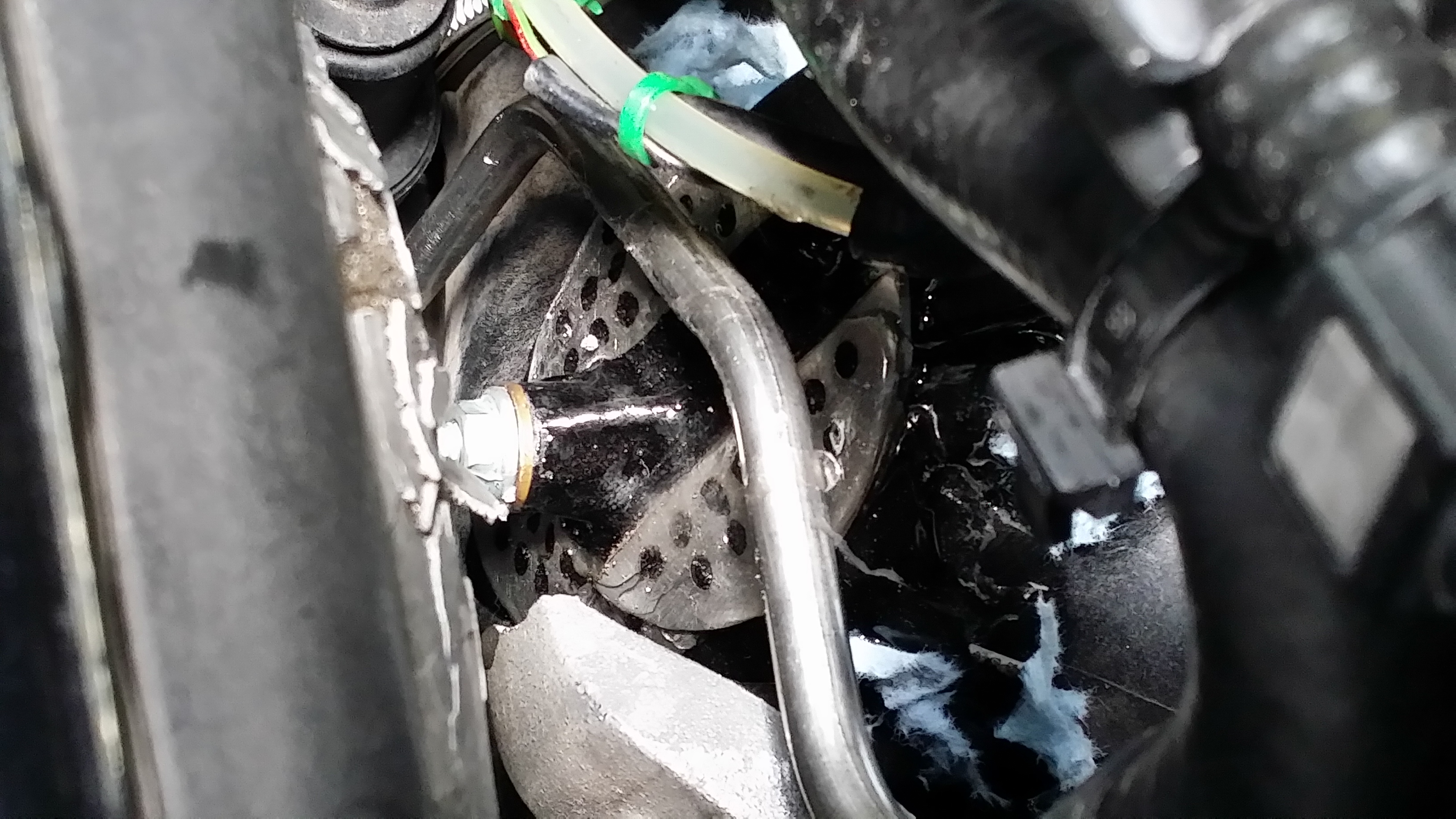

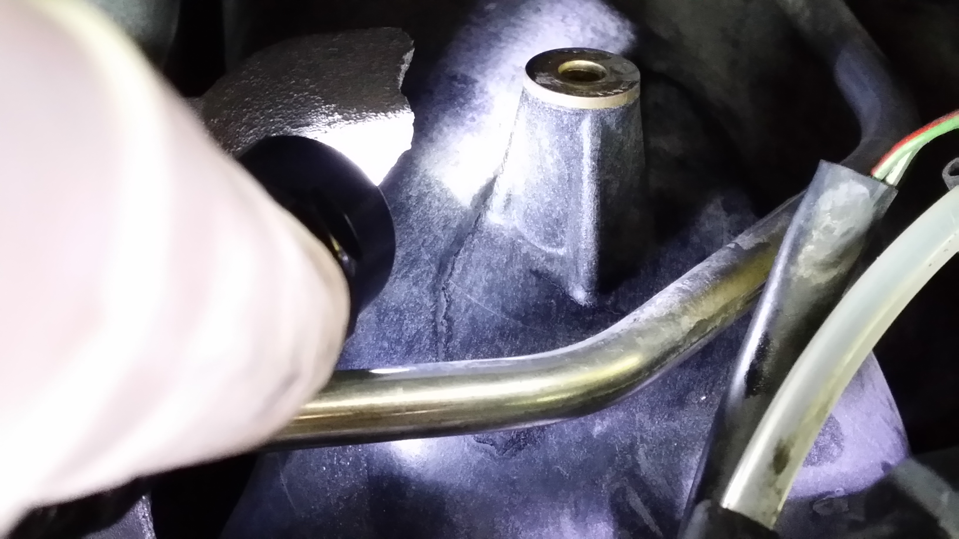

Big u shaped Crack on the plenum around the stand off that holds the aluminum intake . Fixed with epoxy and sst parts. It must have started a wile ago because the car has never been this fast.

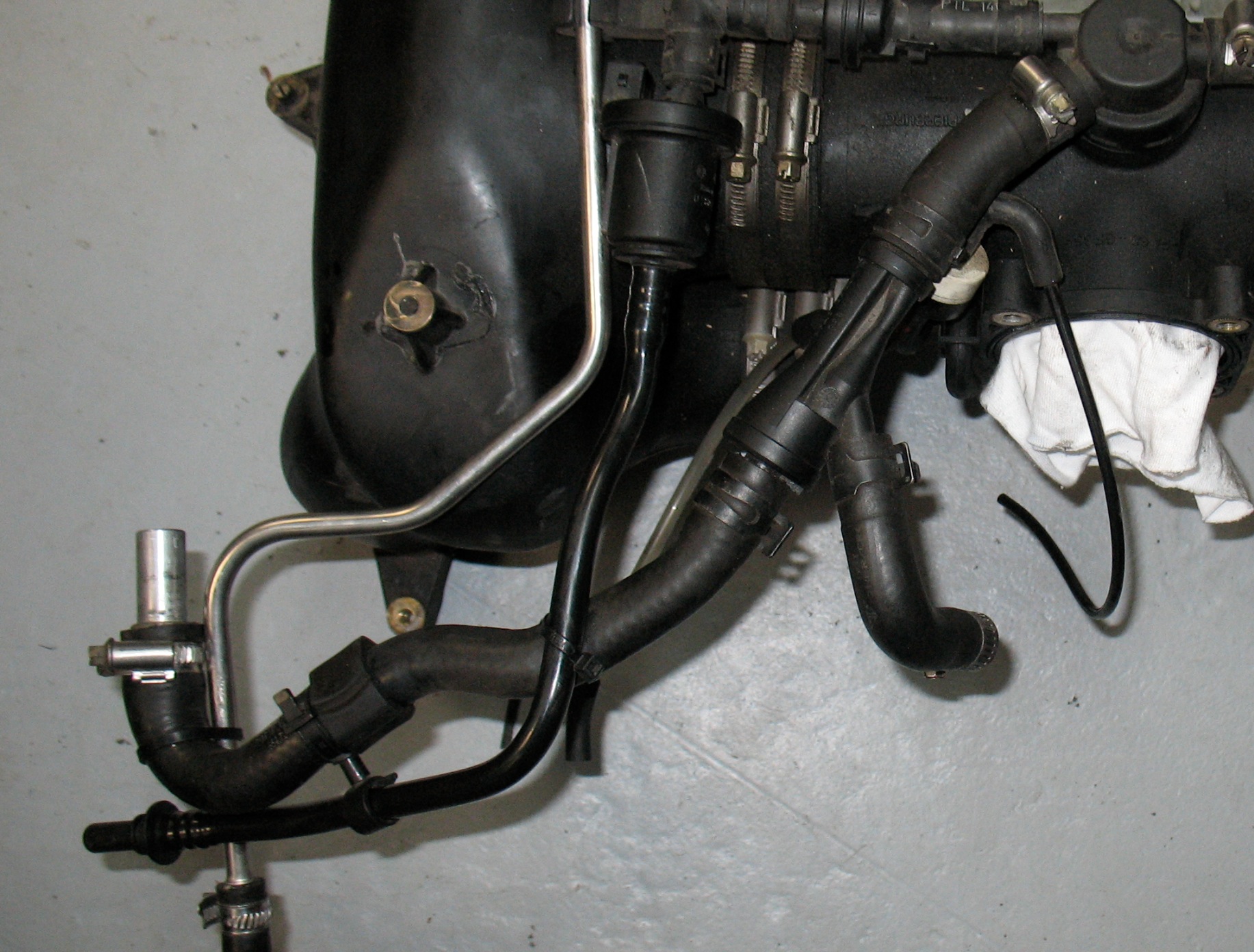

Same problem here. Discover the crack when my engine was removed for coolant pipes welding. Fix it with fiberglass. Hope it will last!

Just went to look at my repair to see if it is holding and I had to use the borescope…Not the best place but with the engine lowered 4 inches this can be inspected properly...
