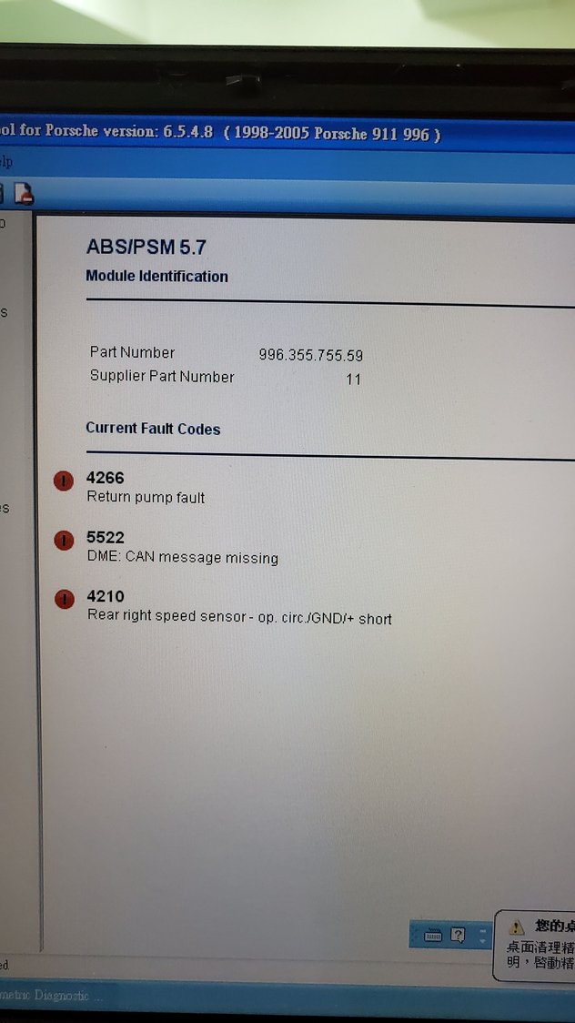

After keep ignore it and It finally pops up the right rear speed sensor code and locked the 3rd gear, mine is a tip. I grab a brand new speed sensor and it doesnt heel, and we found the harness plus looks bad, replaced it with the harness repair kit and all codes are gone, ran 20 miles now only so far, will keep trace.

Just jave a spin again, all good, and then pass through a speed pump, I can feel the abs pulse once...and then the annoying abs psm comes out again, 4266 is back...
The difference is there was no symptoms to pops abs psm before, now I can feel the abs pulse and it might think wrong operated and stop it...
