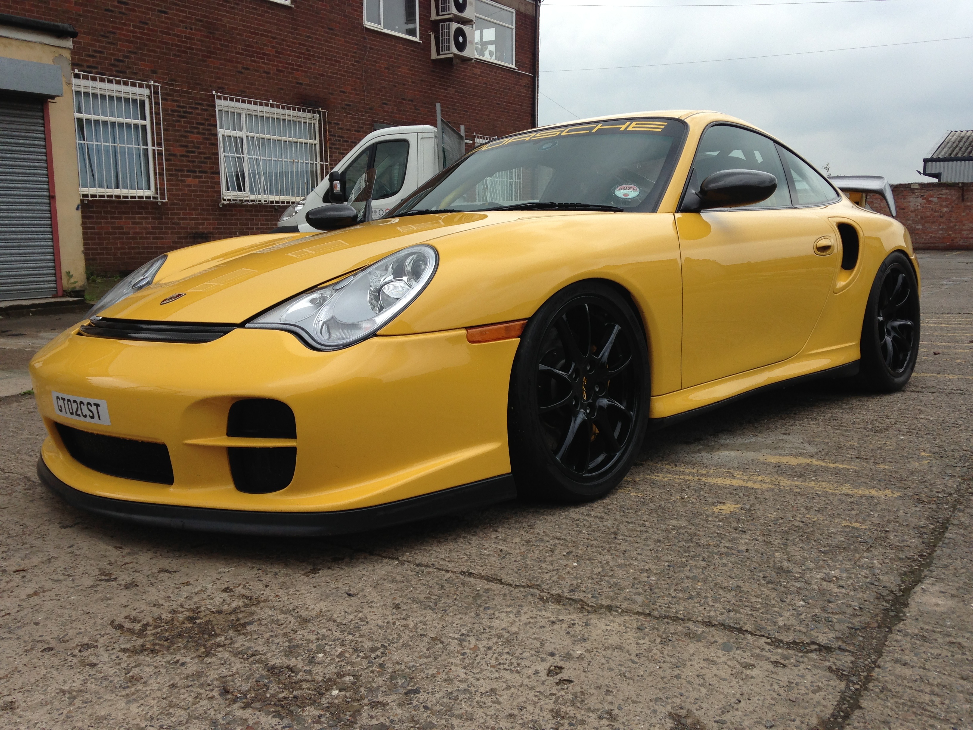

I'm running 265/30 and 325/30 Michelin pilot sport cups with good results, you just have to be careful of the boost pipe behind the left rear tyre as it gets close

Originally Posted by deanchiu
Thanks for sharing. Would this come with good results on tracks?
Please share the photos of your wheels as this would be good as a ref for me selecting the 19s.
Yes I use this combo when I just want to drive to and from the track, when I trailer I use 18" with slicks, or when I drive the nordshleife on tourist days as the car has to be street legal.
I find it very balanced and the best streetable set up on my car, with -3.5 front and -2.8 rear camber.
Here is a picture.
Here is a picture.
Thanks for sharing the setting and exp. it's really helpful. You are car is very very nice looking especially the rims and the yellow. I was unable to find any yellow GT2 in my country so I had to go with black.
I will play around the camber setting as suggested for little bit.
ciao
