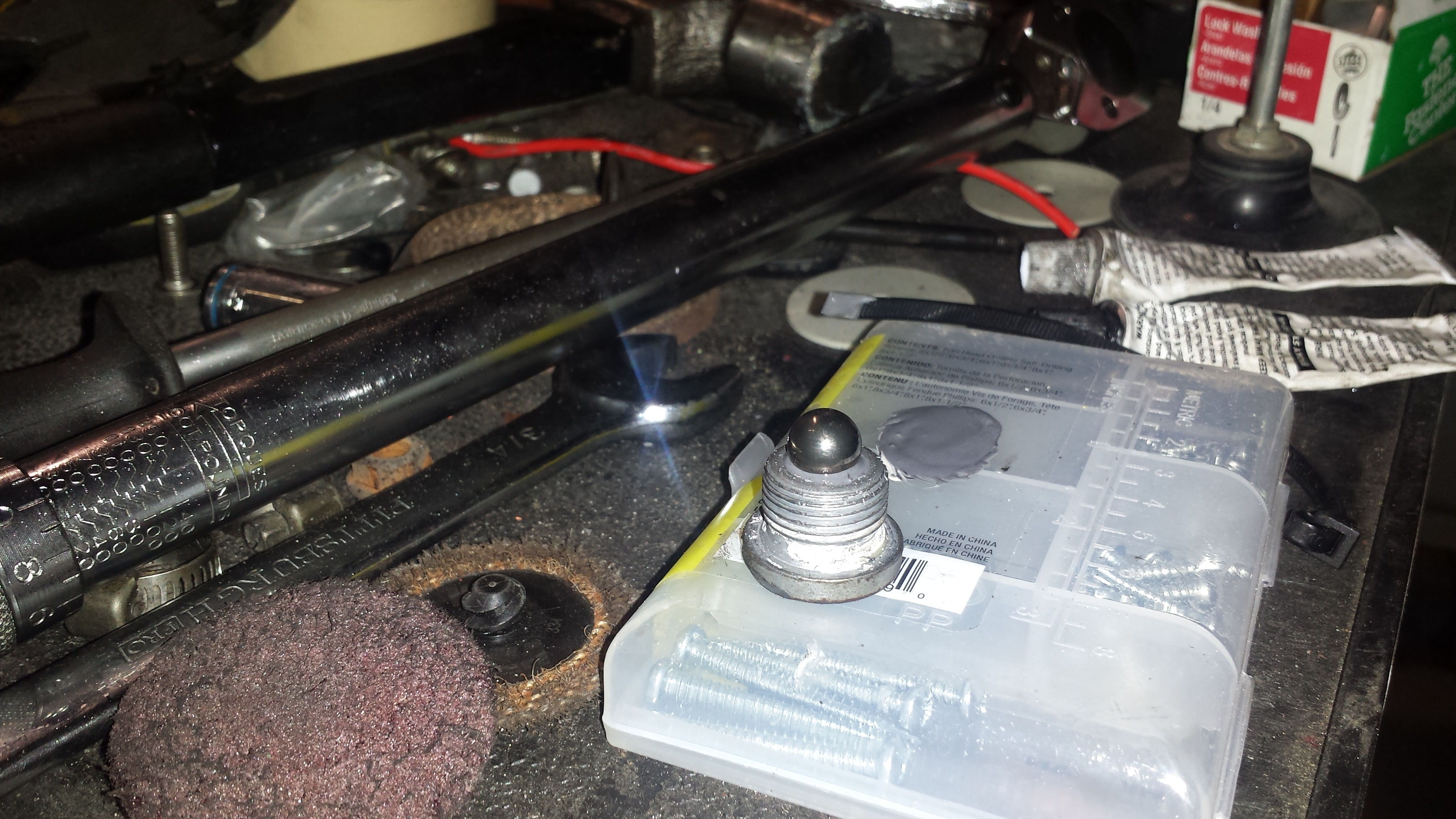

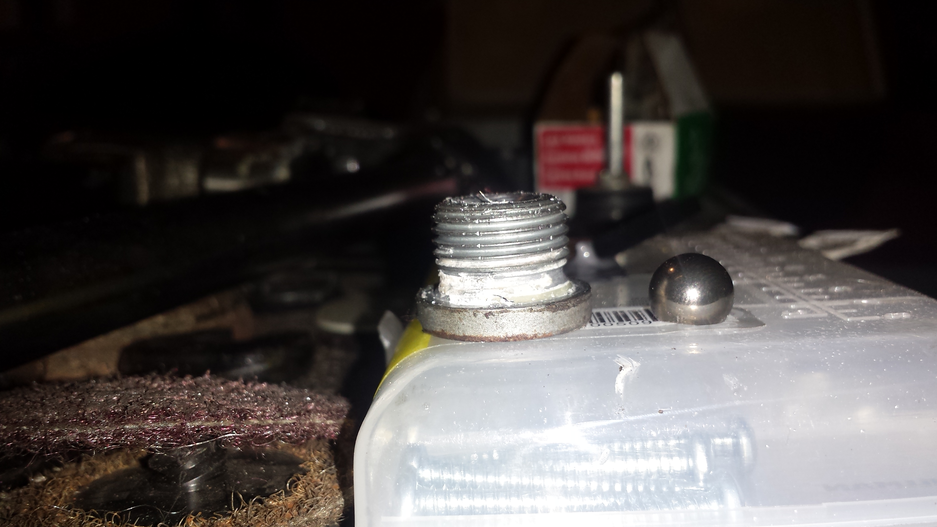

I just put back my engine and while it was out I did that 8mm ball thing, to keep second gear from ever popping out. While my second gear never popped out to begin with, right now I do not seem to be able to shift into any gears.
Car is still not fully assembled and clutch is empty, so technically I only put in the motor and connected linkages, still about 40% of the assembly and bleeding work ahead. Please see my pics and tell me if I need to remove this whole jazz, or is it normal for gearbox to not shift without clutch release.
Ball is exactly 8mm from top of the plug.

Your messing with us, right?
Afraid not, but I can pull it just like I put it in, in about one minute.
This is plug from top of gearbox, above shifter levers.
Its a 8mm ball. you need to drop it inside then put the spring on top. You need a new cap bolt now as you drilled it? to JB weld a ball bearing you ground down.
^^I that order^^
^^I that order^^
Thank you. I was not sure about the order, since never so a picture.
I am thinking if it is designed to increase spring preload by 8mm, then order should not matter. I do have extra cap anyways.
The width of the well seemed a little too large for the ball to stay centered, that is why i did 10mm ball and what you see above.

The detent's range of motion almost has it touching the bottom of the cap bolt/screw. I may have one, that is not a part you can buy. There is no part number available.
So you are saying that with the ball in, there is not way shifter will work? How is it that many others shift successfully with that mod.
Regardless, my second gear was fine, so I'll probably pull that whole thing and cover my drill dimple with a dime.

You were right gentlemen, ball had to drop inside the gear stopper thingie.
Regardless, that plus bolt is identical to BMW 6HP26 transmission drain plug, plus BMW has nice rubber o-ring seal, so no need to mess with thread sealing.
