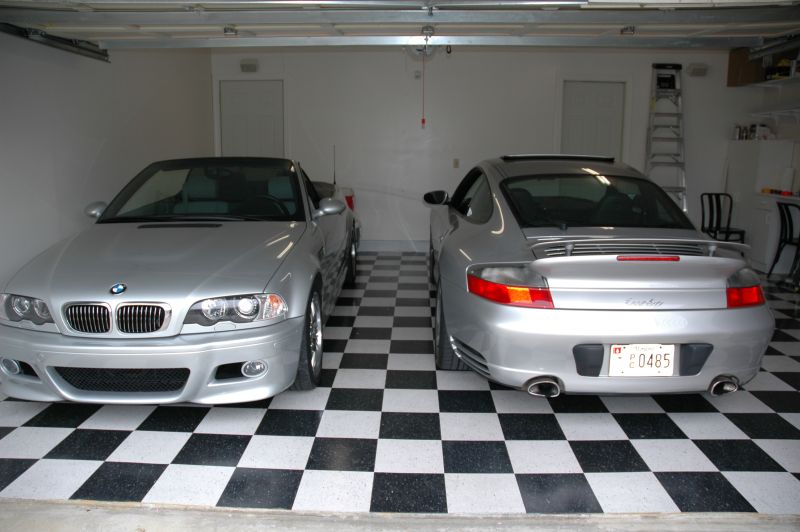

Hey, glad I could be some help. We have similiar taste in cars. I have an 01 Turbo also, but had an 02 M3 cab which I just sold last month. How do you like the new M with the comp package? I am thinking about that exact same car and color too. My Cab was a pig, and did not feel quick like the coupes at all. I also had the AA exhaust, which to me was very loud but sounded nice once warmed up.
