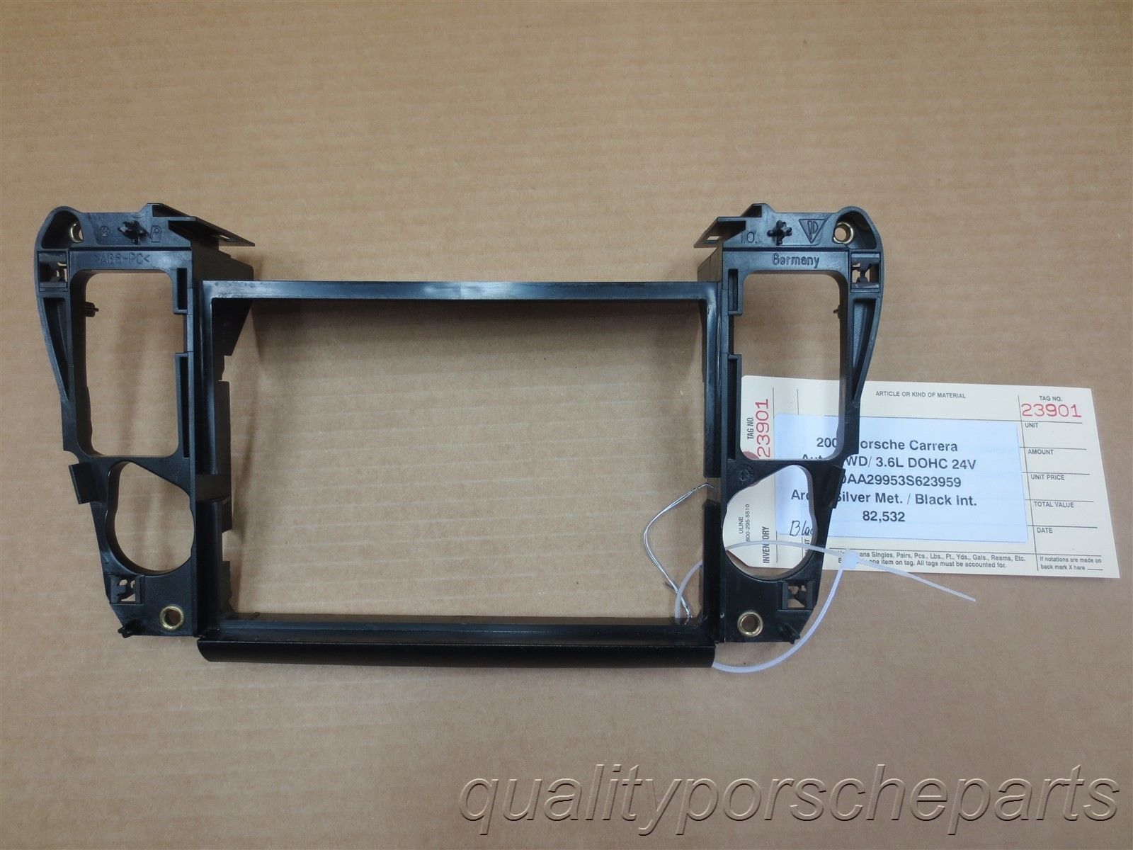

Since I had a little spare time the other day I took the opportunity and started prepping. Moving the HVAC controls to the lower position is pretty straight forward, it just requires pulling the wiring harness back and down which required popping off the carpeted section of the drivers side center console.
My biggest concern after taking everything apart was this front bracket that the horseshoe clips on to. i thought about hacking it up and getting the PCM to fit but I still would like to keep all the original parts to my car just in case I want to put everything back to it's original state one day. After confirming the part number needed I did a quick google search and found a few, just out of curiosity I plugged the part number into eBay and there was 1 nice used piece from an 04' 4s for about 35 bucks, perfect! Should be here by the weekend.
My part: 996.552.231.11
Part ordered: 996.552.231.12
Hopefully I won't need to change the rear cage, I see there are two black clips on both sides that seem to hold the CDR23 down once pushed in, I will try to pull those clips ad see what happens.
