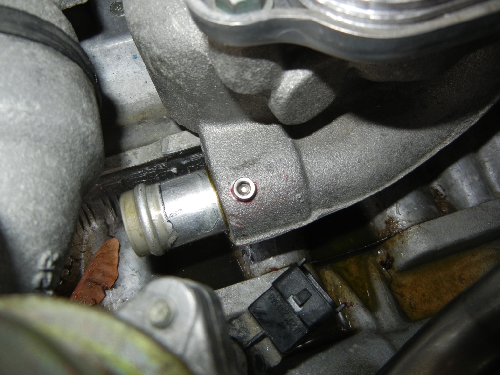

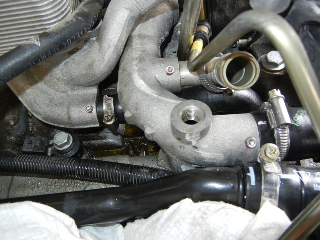

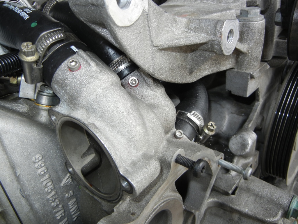

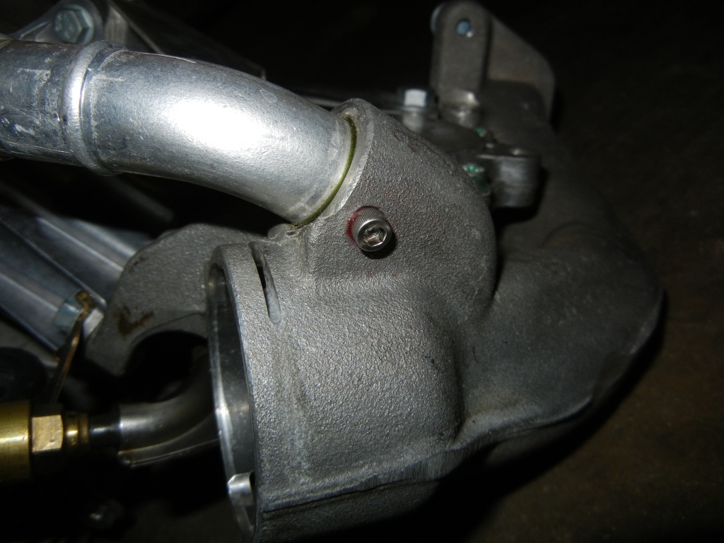

I did mine this Spring...8 pipes in total: 3 behind alternator, 3 by waterpump, 1 by oil cooler, 1 by power steering pump

pinned...see pictures in my original post

was engine/transaxle dropped as an assembly, I have a hoist but same job can be done with floor jack and stands.
I went with pinning for a number of reasons, that I will not go into (starts a thread-war every time, lol)
Great time to do a full cooling system rebuild, W/P, thermostat, hoses, tank, etc...
While driveline is down, also did my 72lb injectors and went over the full intake/vacuum system to retighten and improve.
