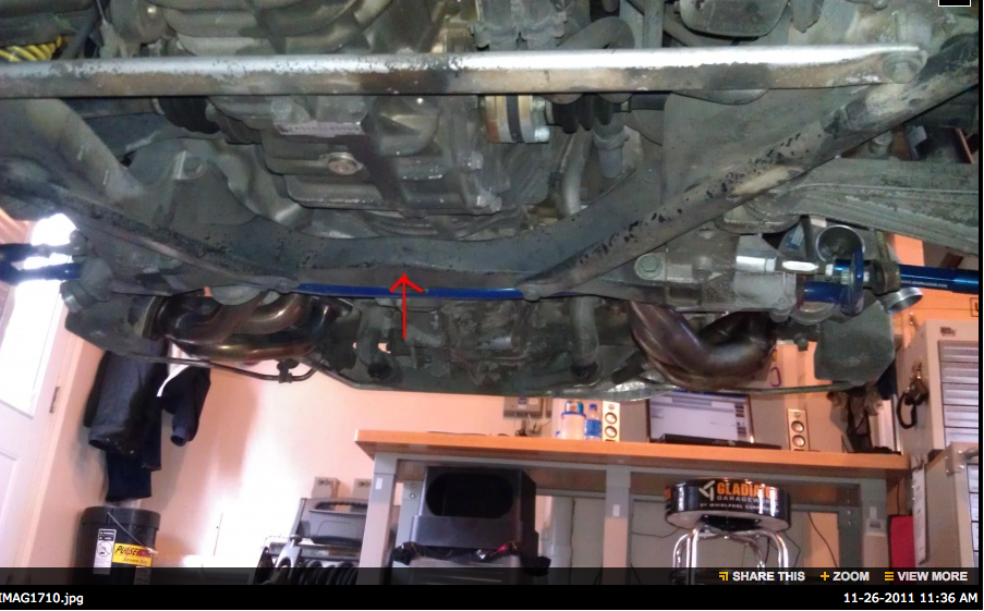

Do a search...this have been discussed for eternity...
I've own several 911 and now a 996TT
I've been doing this since 1985...
Here's another option at cross member or at engine point
Also included alternative jack stand options...
BTW, block your front wheels...
