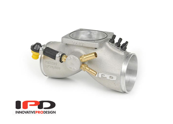

Originally Posted by pwdrhound
The larger 74mm 997TT TB is also a tempting option but you need to use the IDP plenum with that for which no one has ever been able to supply any solid proof of improvement.
I can see why Porsche made the T-design the way they did on the TT as the two banks need to be able to cross talk with one another since they don't have the extra resonance tube like the GT3s The little splitter/diverter in the IDP plenum would seem to interfere with that.
i beg to differ, although i readily defer to your depth of knowledge on the topic, i can only add my barely relevant experience. my experiential and anecdotal results by having simply switched to the 68mm ipd in concert with the oem tb have shown noticeable gain in the low to mid range, and tq was what i was seeking to improve. e.g. more low end grunt.
i'm reasonably certain ( if you a/b the two pieces ( oem vs the ipd design ) together side by side ) that the ipd plenum Y design is an improvement over the T design of the oem plenum and results in an increase and/or less restrictive airflow, and i'm fairly certain, the ipd does not impede "cross talk"? but that is just pure conjecture on my part! but ipd must have made them and sold them successfully for this long for reasons other than results based merely upon conjecture. my point being, i certainly haven't lost any "gain" and in fact may have gained in real terms, beyond even my "seat of the pants" assessment..
..once installed, that became immediately obvious to me, while any gains would ( i believe ) also become immediately obvious to a discerning driver such as yourself.
i cannot imagine that would be any different, by your upgrading to the 74mm w/997tb or possibly even a 78mm? setup? especially if you're about to embark upon the 3.8? ( or is even a 4.0!? re-build which i look forward to following, as you begin and progress ...just my 02
I get it Mark. I'm just going off of a simple google search regarding the plenum. Like I said, there are numerous reports of guys that have installed these on 997.1TT only to take them off after experiencing a power loss. Then you have tons of reports of other Porsche applications where people report they can't honestly tell any difference at all. For obvious reason, I certainly don't believe any dyno numbers provided by the manufacturer. Call me a bit of a skeptic. I have also talked with a number of guys/builders who are way more knowledgeable than myself that have brought up the simple fact that the T-tube arrangement is set up that way for a reason, not simply because Porsche was too cheap or not smart enough to make it like IDP. Allegedly, the reason for the T-style is so that the air can resonate back and forth as the intake valves open and close. The TT does not have a resonance tube to serve this purpose like on the GT3s. I know this is all complex fluid dynamics stuff but bottom line is the simple fact that Porsche likely would have done it differently if there would have been an improvement. They're not stupid. I have a customer that wants to try the plenum/TB on his 6GT3 and we might try it but we will do before and after dyno data to see what we get. I will do the same on the TT to see if there is anything there. Pretty much anyone will tell you that the claimed 35-40 whp improvement claimed by IDP is wishful thinking (marketing). Realistically maaaaby half that on a lucky day. My butt dyno is just is not sensitive enough to discern such a small amount.
Then you have companies like RUF that go to great lengths to make their own post MAF cast intake manifolds (which can't be cheap) and turbo intake pipes, yet they leave the intake plenum untouched. Don't tell me that during development they didn't look at that area as a place to make an improvement? I certainly would. A couple of years ago I spoke with one of the techs in Phaffenhausen and asked why they didn't go with a larger TB/plenum and he basically told me they would have if there was an improvement there.. Both their 550/590 engines retain the stock TB/plenum. All of this makes you go hmmmmm...
I am looking at all options for my rebuild especially if simple bolt ons might add a benefit. I would love for the IDP 74mm plenum/TB to be the magic bullet for the rather modest $900. That would be fantastic. As I said, I'm a bit of a skeptic. I wish it was all that simple but I've learned in most cases that the old saying "if it sounds too good to be true, it probably is", still mostly holds true. My engine rebuild will be a modest hp engine so the question remains what benefit the larger TB would provide at that level. I think I have already pretty much scratched the 997TT intake off the list as there is too much unknown there and I really don't want the deal with rerouting a ton of vacuum lines, etc., for an unknown improvement. I just don't wanna open up a can of worms. I'd rather throw the money into better valve train and bump up the redline a bit.

'02996ttx50's Avatar
Joined: May 2009
Posts: 7,984
From: la
Rep Power: 608
i'm sure you'd be right that ipd's numbers as posted would be optimistic at best, and i'm also of the mindset that porsche *usually* get's it right the first time, but then, we all have some mods or other that we would all consider to be an improvement, and i believe the ipd plenum to be one of them.
i would venture more folks that have replaced with the ipd, whether the 68 or the 74, have kept them, rather than removing them after. but i'm just guessing, i just believe you're on the right track when thinking about how to get more air in and i do believe the way you mentioned, in spite of your doubts might prove to be a good idea. ultimately though, i'm sure your car will continue to be a benchmark for many of us. so,.. was just something to ponder.
ADD: you'd feel +10, i know you would. i do lol
