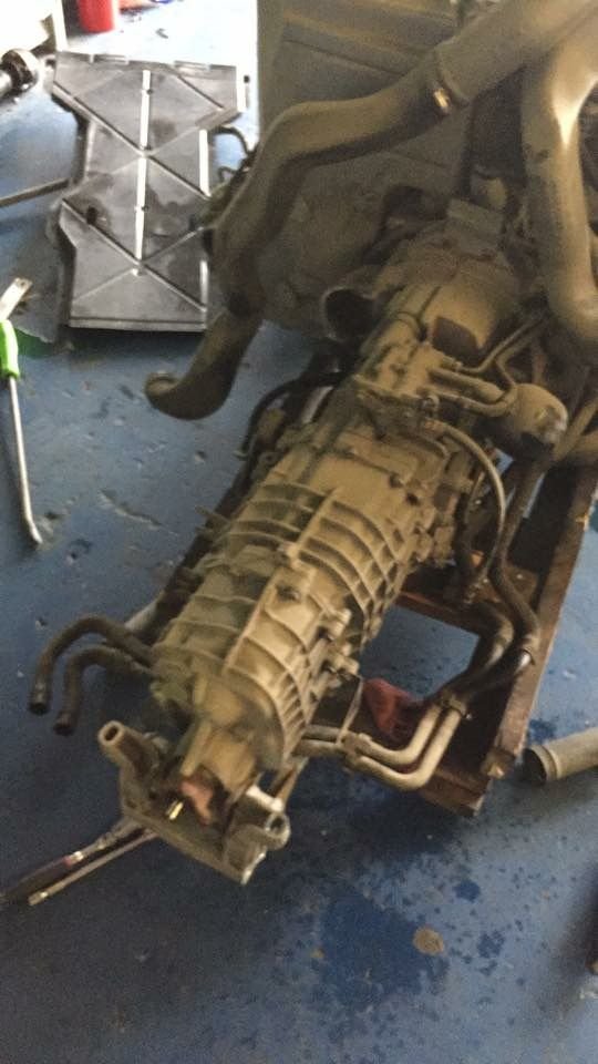

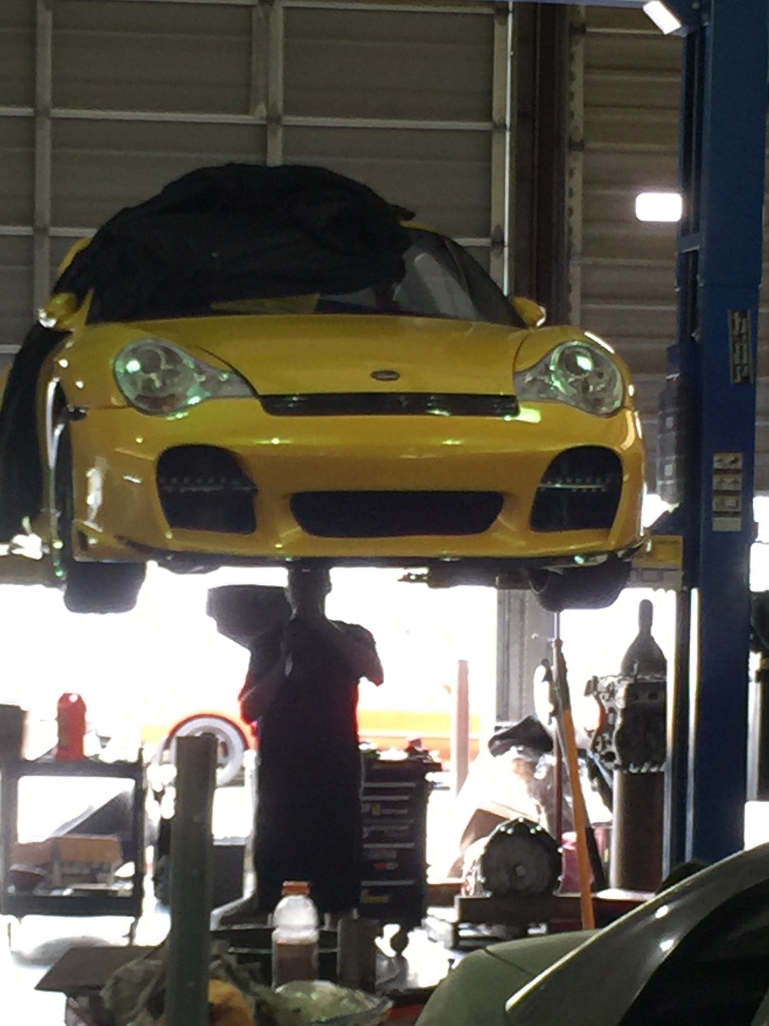

Here is a update about my car.
So its still at Undercover and should be done really soon.. Tim941NYC is waiting on the 997tt Lifters to complete my motor build...
here is a list of the parts for the build:
-Complete engine gasket rebuild kit
-Raceware Headstuds
-Carrillo rod with Car bolts
-FVD Mahle 3.8 piston kit
-GT2 Oil pump
-997TT Lifters exhaust/Intake
-GT2 Slave conversion
-ERP Tripple plate clutch
-Transmission Gt2rs transmission with OS Giken Diff
-RSS engine mounts
-IPD Y-Pipe
-IPD 82mm TB
-IPD 997 Plen
-997TT Intake Manifold
-SRM Stage 3 Fuel system
-FID 1400CC Injectors
-Pro-Efi Full ecu with Coils, flexfuel
-Tial 3073 alpha Turbos
-2x Tial 44mm Wastegates
-2x Tial BOV
-Evoms Intercoolers
-Motec c125 Dash with loogger/ GPS
-Custom Long tube Headers
Ill update the list if something poops up.. but for now thats pretty much it.
Garth estimates to make 800whp pump, 94/oct.
and prox 1000whp on e85. Cant wait to get here back.
