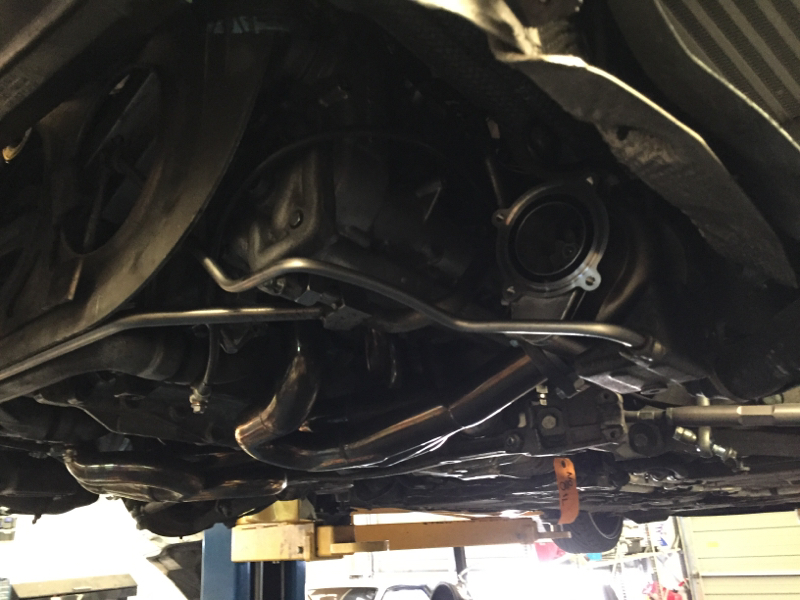

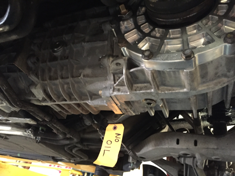

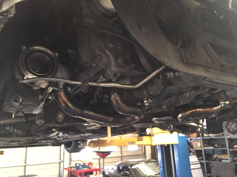

Alright . Motor is in and so are some of the components. Fabwork is getting done . Unfortunately we have a set back, one of the Tial turbos seems to have a problem when Spinning the wheel. It seems as if it touching and Garth can't pinpoint where exactly..
But thanks to SamboTT, he arranged a return label to Tial to have them inspected before we run the car.

Old Oct 24, 2015 | 12:23 PM

I was at the shop a little while ago and felt Abes turbo. Kinda unfortunate and lucky that tech caught that too. I turned the turbo myself and every few turns it felt like the wheel was grabbing metal, seems like a mchining issues in the wheel or the cover itself.
