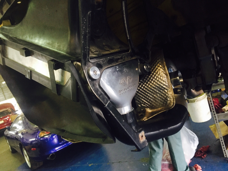

Intercoolers installed.

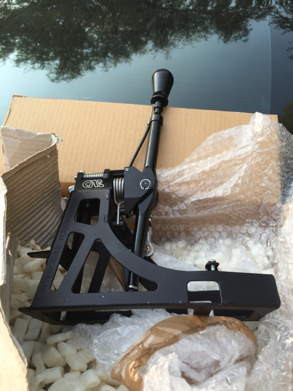

Also had to get me the CAE shifter to keep me on point, when I need to school a few cats lol.. Helps prevent miss shifting because of its accuracy and it save you time getting into gear. Attachment 428711
Sick shifter where did you get it?
