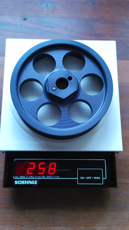

In the pic is mine, by 9products/9xx-parts.com. Nothing dubious in it... My seat-of-the-pants -dyno tells me that it revs more freely.

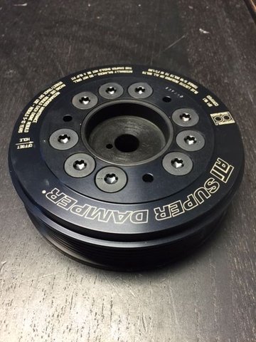

This is what we use in our builds. Harmonic balancer pulley.
Overcomes the problems;
loose flywheel bolts, loose pulley bolt, broken oil pump gears etc..
Highly recommended for manual cars where the flywheels are single mass and very light....

RPM is one thing, whats on the other end of the crank is the other. I always suggest swapping to a Dampener like ATI or lightweight pulley when installing the lightweight flywheel/ clutch setup. In most cases the lightweight RS or EvoMS options are fine, big power options reduced harmonic vibration is always a plus and its' cheap insurance.
