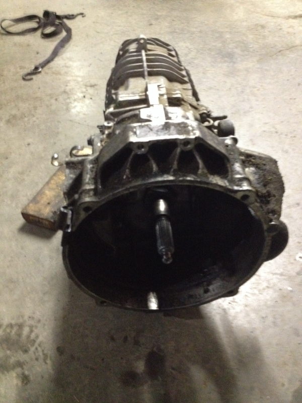

Hi guys the trans is out! The DIY by Talisman is great but I will have to add a line to it regarding removal. The crash brace located on top of the trans housing bolts the trans to the chassis. It was a bear to get to and remove. Long extensions and an air ratchet finally got it. Overall a very tight fit to pass the trans by the coolant lines that cross UNDER the front of trans. Attachment 417733 Attachment 417734

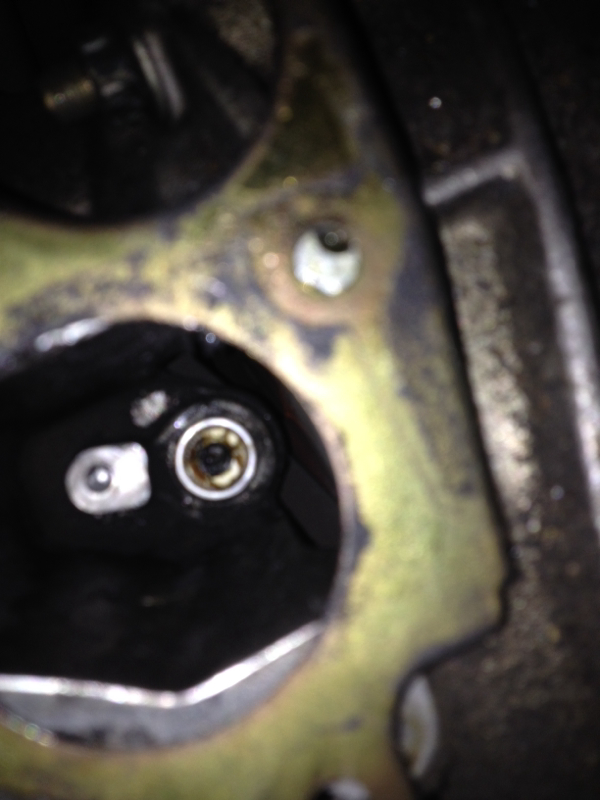

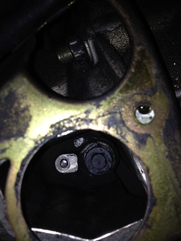

A pic of the inspection hole on drivers side. The left hole is where the 10mm bolt holds the retainer clip. The right is the shaft cover hole. I used a 6mm bolt to thread in to slide shaft out. More to come!

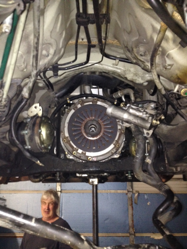

Pulled flywheel today. RMS is leaking. Checked flywheel with a table dial. 0.008" max swing so not gonna replace or turn it. Should be good to go after scuffing and cleaning. Pressure washed trans. (pretty grimey) ordering RMS and will change slave and accumulator while I'm waiting for it to arrive. Will replace fluid in gearbox. Redline? OEM?

Cool Brock. You can't turn these flywheels anyway. I would use factory gearbox oil and also on a factory RMS.
If you need a sleeve and accumulator quick I have it in stock.
