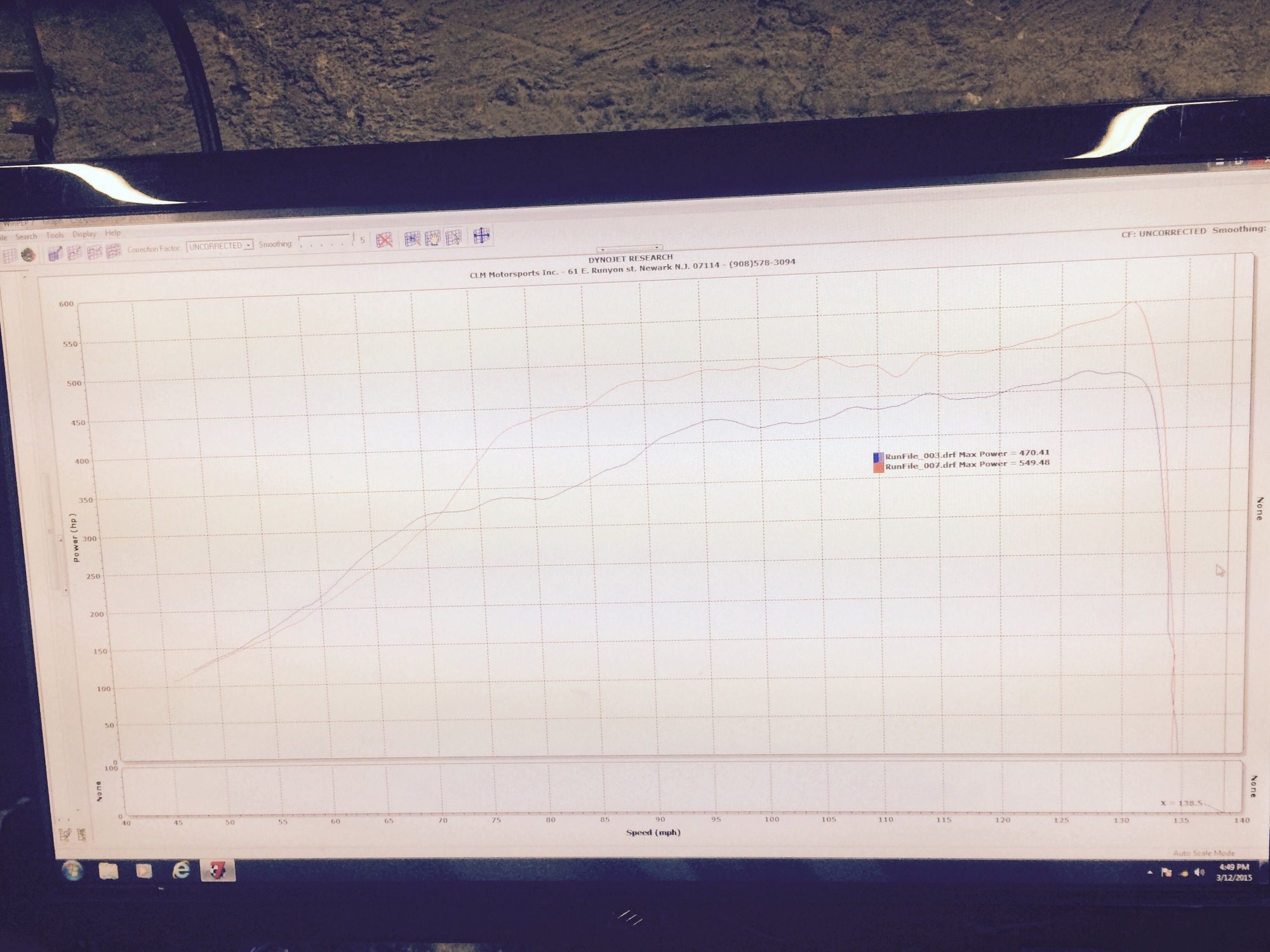

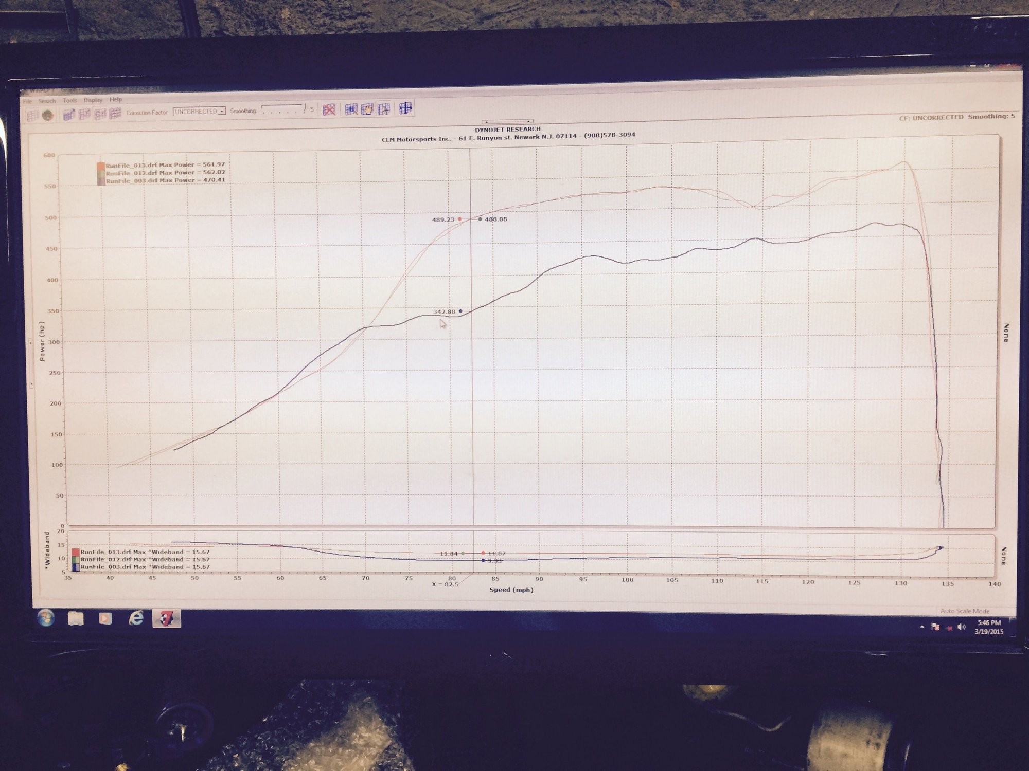

Steve, at this level we decided to stick with a 5 bar. Generally speaking if you try to squeeze too much out of it it's definitely not the right choice. I have literally been doing power kits similar to this air fuel ratio and horsepower for 13 years on these cars. I would never allow one of my customers to put their car in jeopardy. Depends on the tuner. I have the utmost faith in GIAC and their capabilities. The power is tapered in allowing the car to handle fuel delivery. Their tuning on the 996TT is sometimes criticized for how "conservative" it is. But to me it's safe and well done. That is why they are one the tuners have been around the longest. With their later tunes and a proper configuration I assure you the car runs like a beast and there's no worries on safety. Th epower, that is there too! 993-991. Many people know i do work with others as well. Whatever fits the build. Here's a few dynos...one on pump gas and one with race fuel same tune. Joe just did this a few weeks ago. You can see where the car corrects when hundred octane is used just like GIAC said it would due to fuel limit and they run them safe/FAT. Hands-down one of the best pump gas set ups on a budget that I have seen. Contrary to a lot of comments about sub 500rwhp GIAC 996TT's with K24's or hybrids.
Brock I guarantee if you Dyno your car the graph will lay right where this car and all the rest do!
This is GIAC K16 with bolt-ons vs. my By Design Tial 68mm billets, 3.5 IC's and a 5bar with the next level GIAC tune we did.

Am I reading the dyno graphs right? It went from 470hp with 93 octane to 560hp on 100 octane? If the jump is actually that high that is pretty cool!
