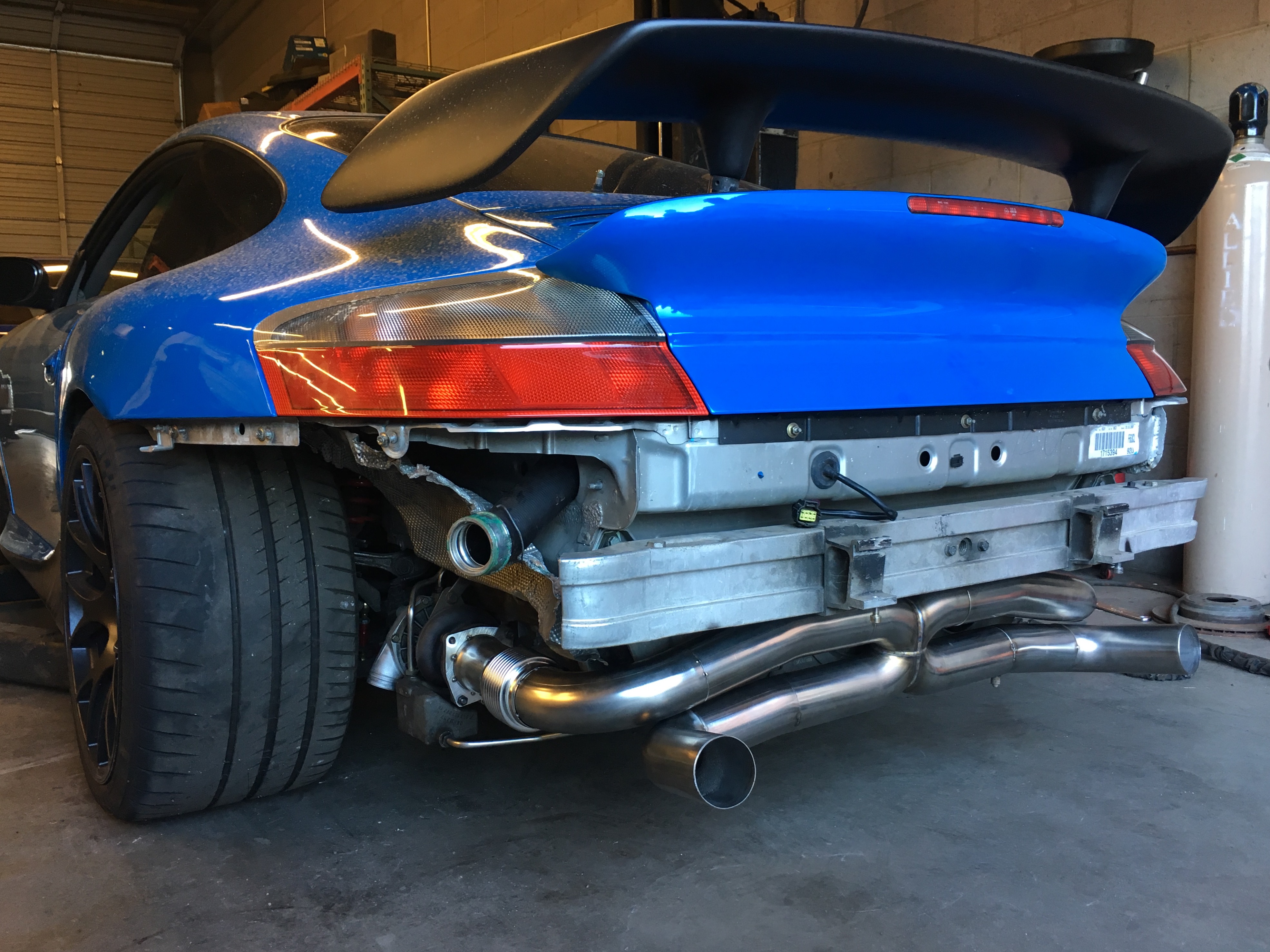

I'm running 19x8.5 235/35/19 & 19x12 with a 305/30/19 with Michelin pilot sport cup 2's. I'm lowered on H&R coil overs. It rides great with no rubbing at all.
ID:	460286   Click image for larger version
