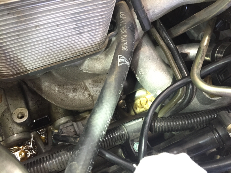

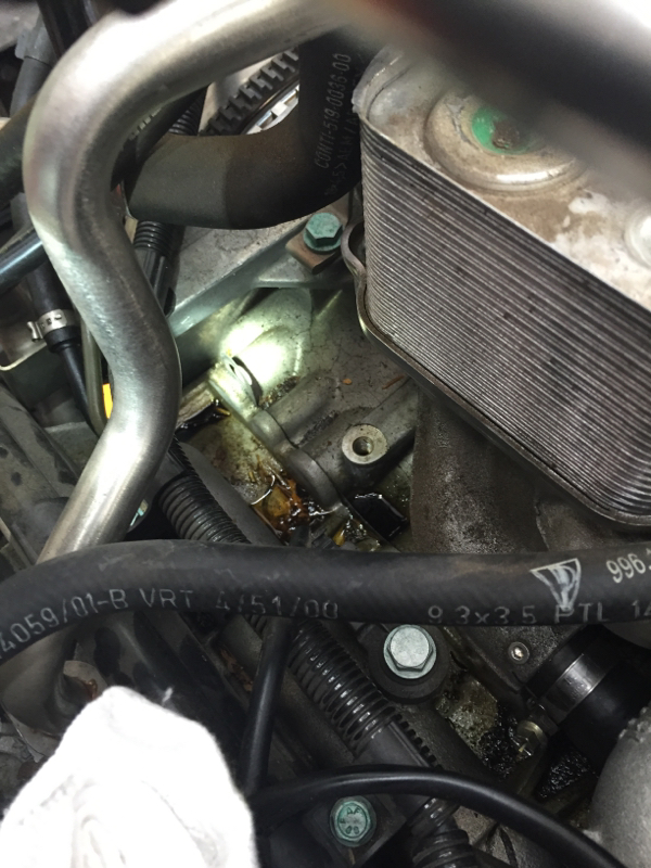

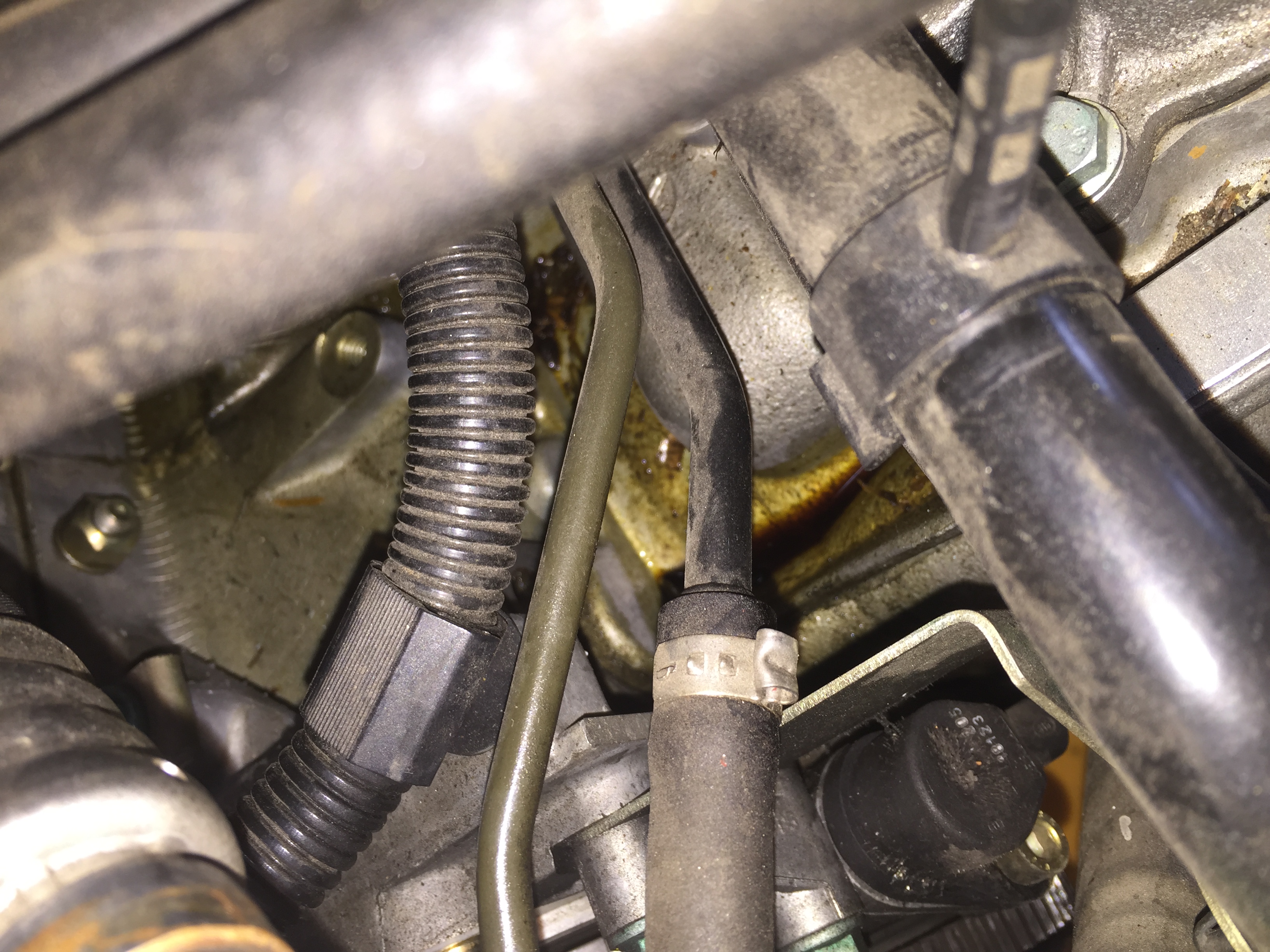

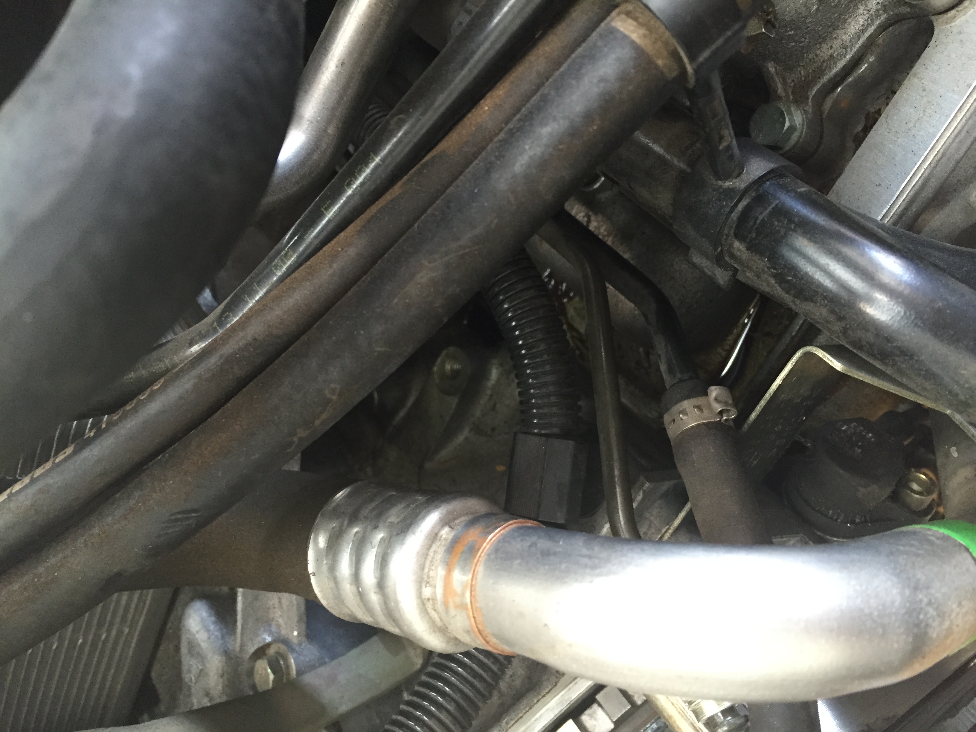

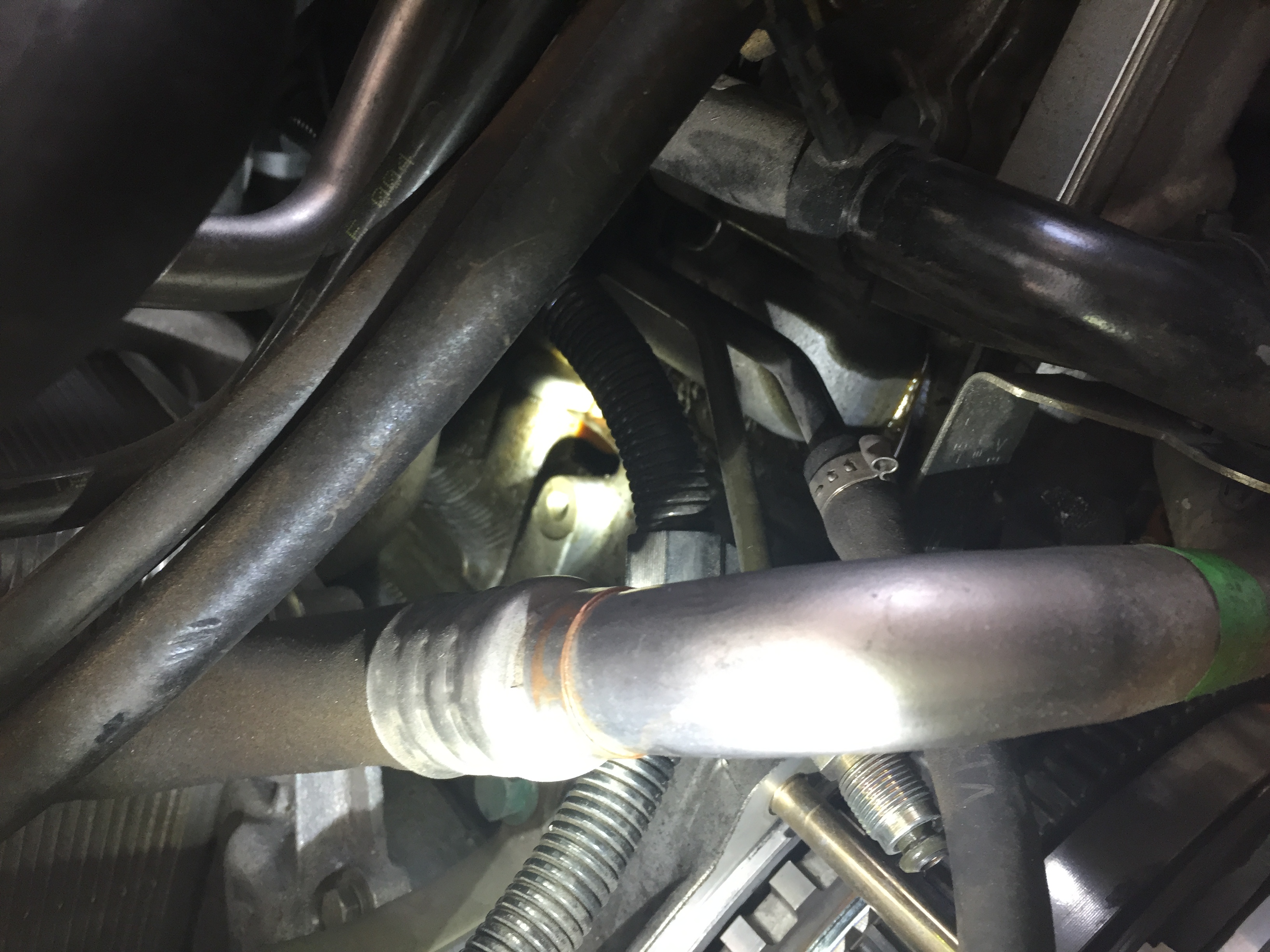

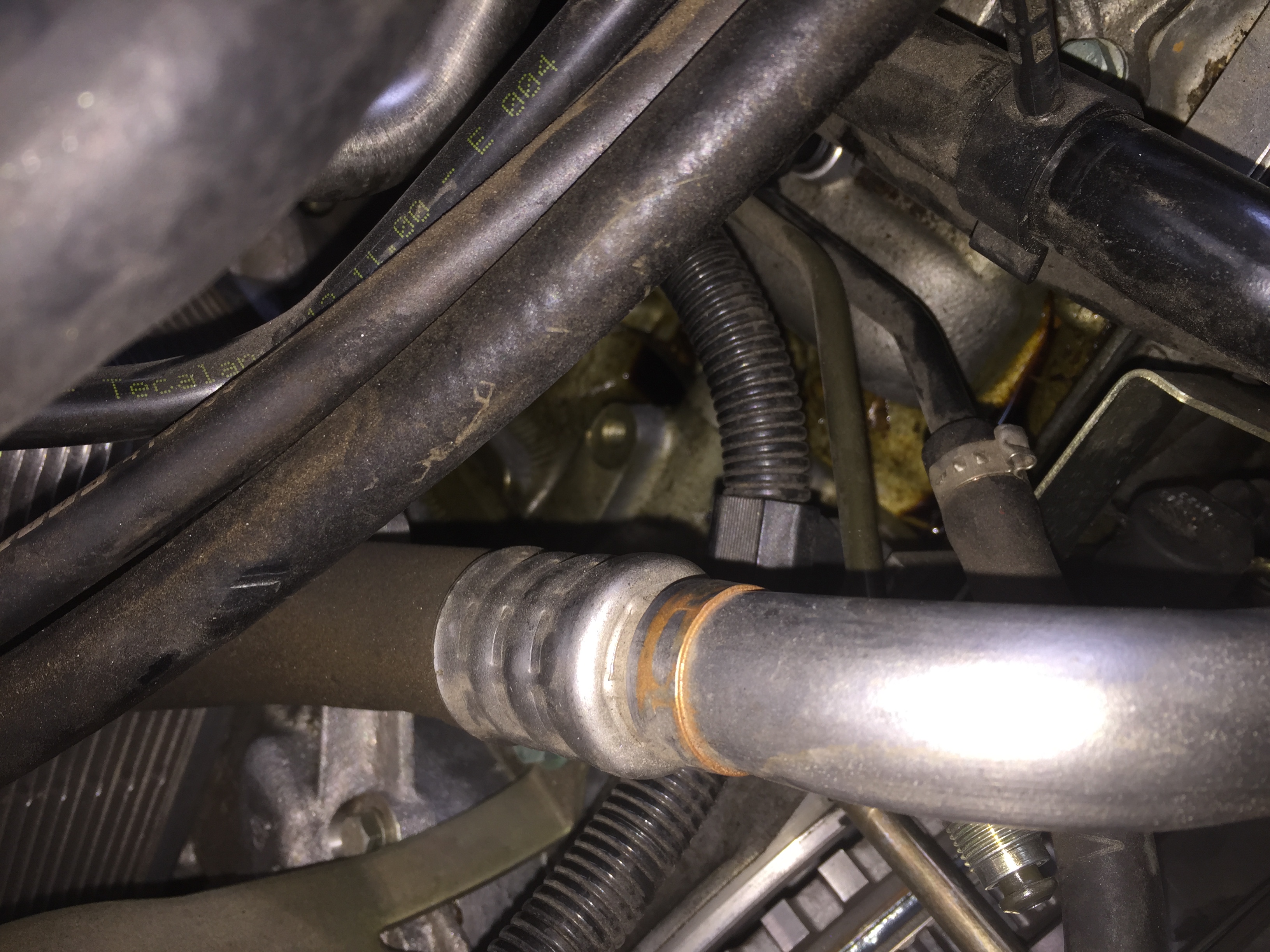

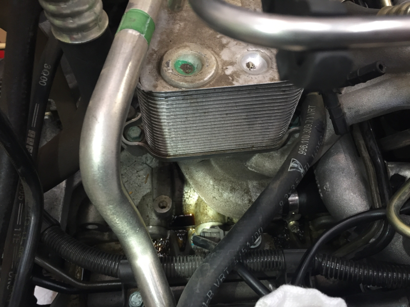

Yeah I went down this morning to look for myself I couldn't find where it was leaking either looks like it's coming from the middle of the top engine. I really don't think its my head-gasket because the oil is pooling up on top of the driver side of top engine. I gave him the green light to remove everything on the top of engine to find the leak so hopefully know more this Thursday. Here are few pics from the driver side top engine
ID:	417460   Click image for larger version
ID:	417461   Click image for larger version
ID:	417462   Click image for larger version

Old Apr 7, 2015 | 04:38 PM
602996TT's Avatar
Joined: Nov 2009
Posts: 344
From: arizona
Rep Power: 45
602996TT has a brilliant future602996TT has a brilliant future602996TT has a brilliant future602996TT has a brilliant future602996TT has a brilliant future602996TT has a brilliant future602996TT has a brilliant future602996TT has a brilliant future602996TT has a brilliant future602996TT has a brilliant future602996TT has a brilliant future
Update: So far no luck finding the leak my mechanic removed the intake and spent half hour looking everywhere with a bore scope and feeling everywhere, he couldn't find or feel any leaks. He found a brown streak that's about .5mm WIDE and 4mm LONG that looks like the sealant they used on the oil cooler console. He said it felt dry to the touch so he doesn't think it's oil but it might be? So the next step is to take off the oil tank, alt, power steering pump, power steering bracket, fuel lines, coolant lines, secondary air line basically everything off the top of the engine down to the long block. Not sure what to do but since I am this far with the engine out I told my mechanic to do what you have too to find the oil leak. I was really hoping that once the engine was out the leak would be very easy to see but not so far and still waiting from my transmission builder to see what went wrong with my rebuild. I am starting to really not like my car now.

Thanks I just got back from the shop and my mechanic nor I could find the source of the leak even with the borescope. My mechanic thinks that I possibly spilled oil last oil change in October in which I highly doubt it but anything is possible. At this point he's advising me not to take the rest of the engine apart to the long block and to clean it really good and put it back in and hope it doesn't start leaking again.
