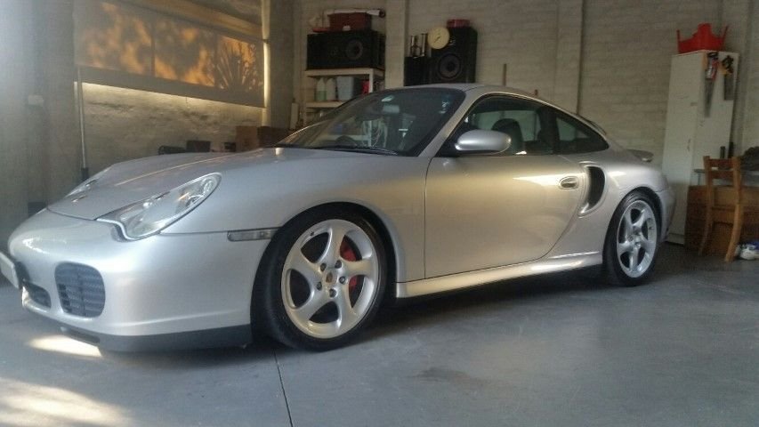

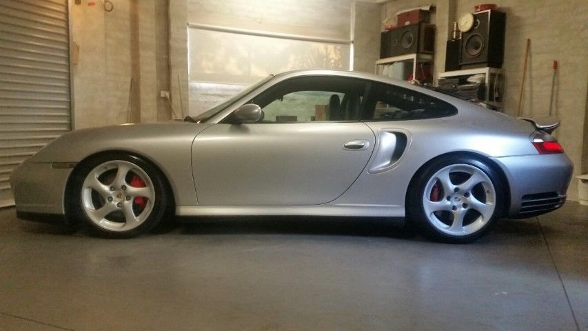

After a few adjustments it does seem to handle a lot better. Especially now that I am within height specs and fitting front drop links supplied by Bilstein until the new Tarett ones arrive.
The wrong length links were causing the front sway bar to bind with the lower control arm, so I'm sure this would have been a major contributing factor in the way it was performing.
John pdrwhound suggested 996GT3 4 way adjustable rear sway bar. He said it is a direct bolt on and can be done under 30 minutes. And if I want more adjustment, i can install front and rear adjustable sway bars. Eibach makes a relatively cheap hollow set of sways for the 996TT.
I might look into them down the track as well but definitely not rushing into anything right now.
Has anyone does one of these two options with PSS10's, I love to hear it if you have.
New stance with 1 to 2mm higher than Bilsteins specified lowering heights.
Front is now 4mm lower and back 5mm higher than than last adjustment.

Did the rear end firm up once the shocks were adjusted Jimbo?
Old Oct 2, 2015 | 09:56 PM
  #133
JimTT's Avatar
Joined: Jan 2014
Posts: 519
From: Melbourne, Australia
Rep Power: 76
JimTT Is a GOD !JimTT Is a GOD !JimTT Is a GOD !JimTT Is a GOD !JimTT Is a GOD !JimTT Is a GOD !JimTT Is a GOD !JimTT Is a GOD !JimTT Is a GOD !JimTT Is a GOD !JimTT Is a GOD !
Yes they have but it might need a new wheel alignment now that I have fiddled with it.
